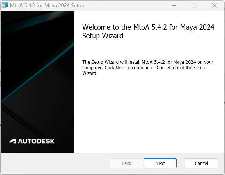

  1. Go to the Product Updates page. Select Extensions, and then download the MtoA installer for your version of Maya. Further information about downloading Arnold plugins can be found here.
  2. Double click on the downloaded .exe file to start the installation. On Windows 8 you may get a warning message saying "Windows protected your PC". If this happens, click "More Info" and then click "Run anyway" to proceed with the installation.
  3. Keep the default installation options, and click through the Setup Wizard until the setup is completed.
  1. Choose which features of MtoA you wish to install and where you want to install it.
  1. Choose the folder where MtoA will appear in the Start menu.
  2. Click Finish to close the Setup Wizard.

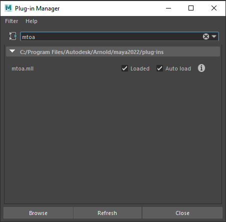

  3. Start Maya and click Window > Settings/Preferences > Plug-in Manager.
  1. In the Plug-in Manager, click the Loaded and Auto Load checkboxes for mtoa.mll, and then close the Plug-in Manager.
You should now be able to render with Arnold.
