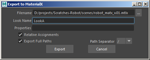

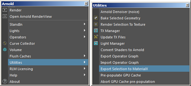

  • First, select the robot geometry (whose shaders you wish to export) and go to Arnold > Utilities > Export Selection to MaterialX.
  • Choose where you want to save the .mtlx file and give it a look name.
  • Assign different shaders to the robot model (ie red & blue, green & yellow and black & gold) and repeat the above process, but choose Look B and Look C for the Look Name. Choose to save to the same .mtlx file (the Looks will be appended to the file).

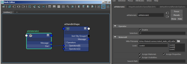

  • Create a Procedural stand-in and open the robot.abc file.
  • Create a MaterialX operator and connect it to the input of the stand-in.
  • Open the .mtlx file that we exported earlier in the materialX operator. You should see the A, B and C Looks that we saved to it.
  • Lastly, add /* to the Selection. This will add the look to the robot selection.
  • Render the scene. You should be able to choose which look you want from the materialX look and it will update in the render view!
