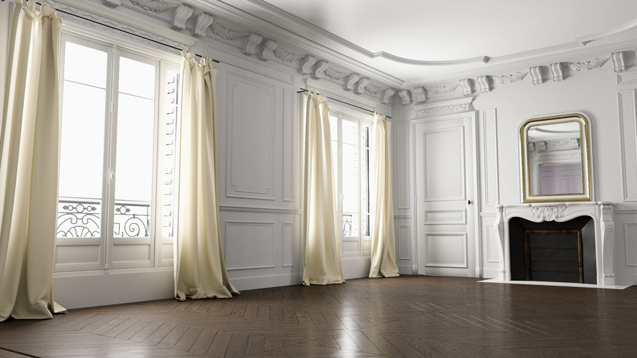

This tutorial will look at various ways to reduce noise in a Parisian interior room scene. Typically, a large number of diffuse samples is required to reduce the indirect noise in an interior. However, render times can increase dramatically with high diffuse samples samples. We will, therefore, look at denoising (OptiX™ denoiser and the Arnold denoiser) to reduce the noise without having to use such a high number of diffuse samples.
Denoisers consider a neighborhood around the current pixel and look for similar neighborhoods inside a given search area to blend together.

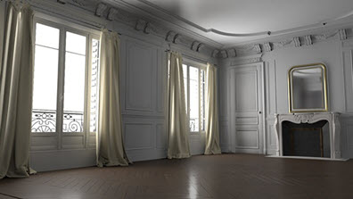

The room is lit using a skydome light (at least 3 samples recommended) with a light portal positioned outside of the windows. Note that the above final image uses a diffuse ray depth of 4, whereas the test images below use a diffuse ray depth of 1 and therefore appear darker. Also, note that Camera (AA) samples have been set to 6 for all renders.

Diffuse Samples: 2 (default)
Now we will render the scene using the default diffuse samples (2). It is very noisy especially in the indirectly lit wall on the left. We can see that the OptiX™ denoiser struggles to produce a clean image with such a low number of diffuse samples.
