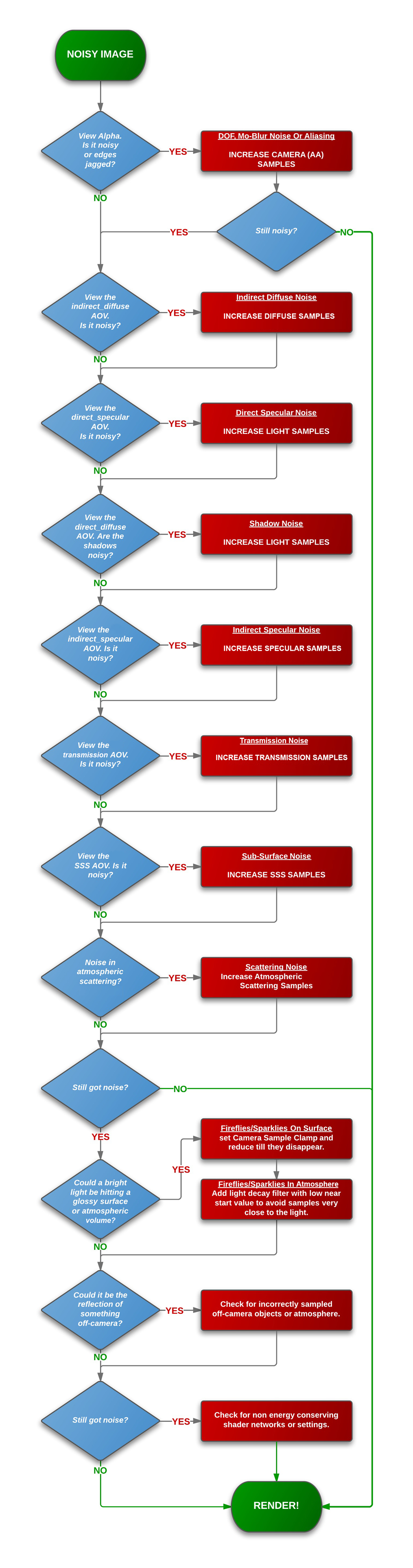

    The diagram below shows a good method for identifying the type of noise in your scene and which sampling parameter to use to improve it.
