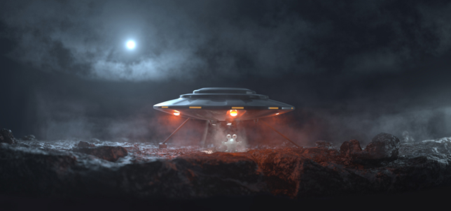

This 'making of' tutorial covers lighting and rendering volumes as well as some other issues when encountering certain kinds of noise in the render. This scene has the potential for 'fireflies' to appear as it includes small visible light sources, highly specular surfaces, and atmosphere volume.

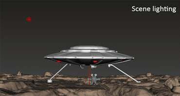

Scene Lighting

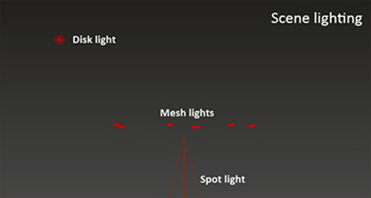

The scene is lit with an area light with its light shape set to disk (moonlight). The UFO's lights are geometry that have been converted to a mesh light. There is also a spot light pointing underneath the UFO and an area light on the right side. Atmosphere volume has been enabled in the MtoA Render Settings window.

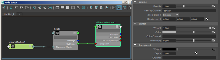

Cloud shader assigned to a sphere that represents the cloud layer
- A standard volume shader is assigned to the sphere (increase the step size of the sphere to 0.1 for it to render as a volume). A Maya 'Cloud' texture is connected to the transparent color.

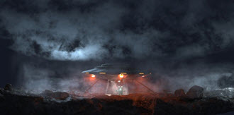

Once rendered, the clouds should look like the image below:
Disk light representing Moonlight with atmosphere_volume enabled.

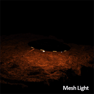

Mesh Light
The UFOs light's consist of geometry that has also been converted to a mesh light. When a mesh light is created, it is positioned in the same place as the geometry from which it was generated. This can be a problem when sampling light rays and shadow noise may appear. One way round this is to disable casts_shadows and receive_shadows for the geometry. Another solution is to move the light away from the object (see images below).

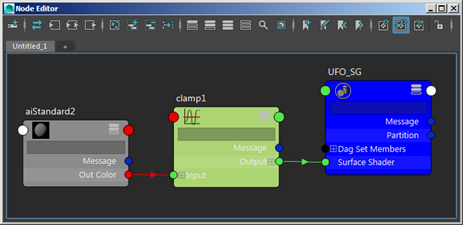

Clamp Sample Values
One option to reduce noise is to clamp the sample values of the rendered pixels. However, this will clamp the pixels for the entire image. One way around this would be to clamp the pixels for a particular shader. To do this:
- Middle drag a Maya 'Clamp' node onto the 'Surface material' attribute of the Shading Group for the material that you want to clamp (in this case a standard surface shader).
Clamp -> Surface material attribute of the Shading Group of a standard_surface shader

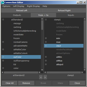

- Connect the 'outColor' of the standard surface to the 'input' attribute of the clamp.
The shading network should look like this:

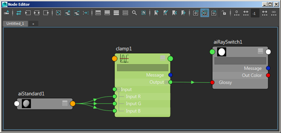

In the example below, the specular attribute of a standard surface shader has been connected to a Maya clamp node. The clamp node is then connected to the glossy attribute of the ray switch shader. It will work as a secondary ray clamp instead of the general clamp in Render Settings window. This way you get the benefit of keeping your range in the direct highlights, but you can also control any secondary ray noise.

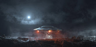

Atmosphere Volume Fireflies
In the image below you can see the effect that enabling atmosphere_volume has on the scene.
Enabling atmosphere volume has introduced some 'fireflies' on the ground material. This material has some specular which is contributing to the fireflies. This is more noticeable in the foreground of the image. A simple way to reduce the 'fireflies' would be to reduce the amount of specular on the ground material. If this is not possible, increasing the specular samples to 4 helps to remove the fireflies.
