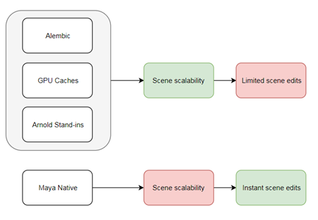

Alembic files, GPU Caches, and Arnold Stand-ins have limited flexibility in what you can achieve with render time shading effects

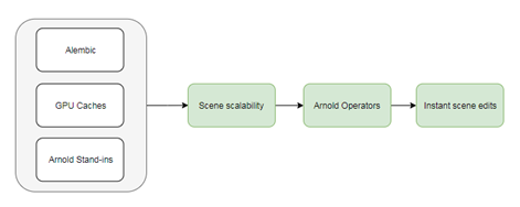

Operators can give you far more flexibility with assigning shaders at render time
