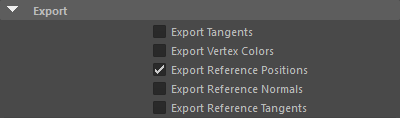

Export Tangents
Exports the per-vertex tangent information as Arnold user data of vector type. This user data can be later queried within a shader for different computations. See the example below:

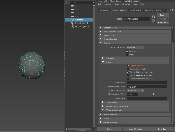

Export Tangents enabled

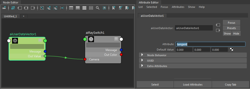

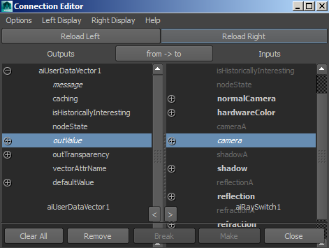

  • Assign a shader to the mesh (in this case a ray_switch and connect an aiUserDataVector node to the Camera attribute of the ray_switch).
  • Type ' tangent ' into the Vector Attr Name of the aiUserDataVector node. If it does not work, try exporting the scene as a .ass file and check that the tangent naming is correct.

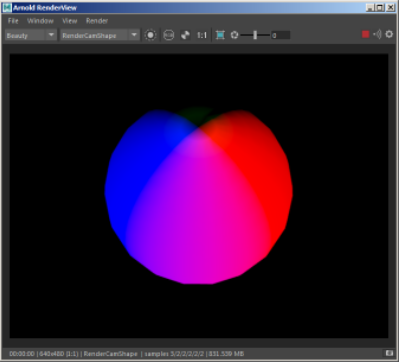

When rendered you will see the sphere's tangents represented by color:
Export Vertex Colors
Exports the per-vertex color information as Arnold user data of vector of RGBA type. This user data can be later queried within a shader for different purposes, like a mask. See the example below:

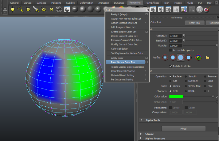

  • Use Maya's Paint Vertex Color Tool to paint the vertex points to the color(s) of your choosing.

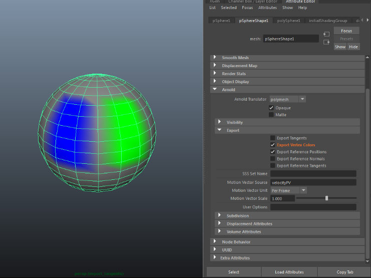

  • Select the mesh whose vertex colors you wish to export and enable Export Vertex Colors within the Arnold attributes for the mesh:

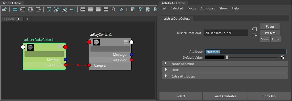

  • Assign a shader to the mesh (in this case a ray_switch ) and connect an aiUserDataColor node to its color output ( Camera attribute when using the ray_switch ).
  • Type the name of the color set you want to use into the Color Attr Name of the aiUserDataColor node. In this case 'colorSet1'. Be careful, the name is case sensitive.

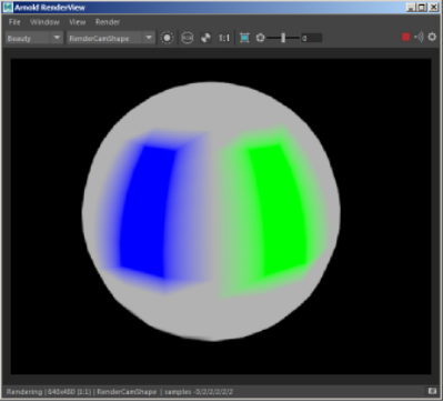

When rendered you will see the spheres Vertex Color representation.
Export Reference Positions
This option exports the vertex positions of a texture reference object in the Pref user data parameter of the polymesh. Pref positions are used with procedural textures to avoid swimming when the mesh is distorted.

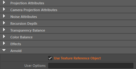

The Maya 3d texture projection will always use the reference positions if they are available. However, there is an option to disable its use in the Arnold attributes of the 3d texture node. For example, this option may be useful if you want to use the reference points with displacement using a 3d fractal texture (so that it sticks) and a projected color texture map which you don't want to stick or be distorted by the displacement.
Maya 3d texture projection with 'Use Reference Object' enabled (default).

Export Reference Normals
This option exports the normals of a texture reference object in the Nref user data parameter of the polymesh. Nref is used in the triplanar mode of the Maya Projection shader.
Export Reference Tangents
This option exports the tangents and bitangents of a texture reference object in the Tref and BTref user data parameter of the polymesh. These can be used in custom shaders.
