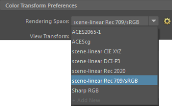

Color Space
The Color Space attribute allows you to set a specific color space to output rendered images. By default, 8-bit images use the View Transform (sRGB gamma by default) through the Use View Transform option, and 16/32 bit images use the Apply Output Transform to Renderer (disabled by default) through the Use Output Transform option. The Raw option is to not apply any color transformation.
Enabling the Apply Output Transform to Renderer from the Maya Color Management preferences allows to set a dedicated color space to the renderer if Use Output Transform option was selected.
Using the Raw option or the Use Output Transform option (when Apply Output Transform to Renderer is disabled) do not apply any color transformation so the Rendering Space from the Color Management preferences is the color space of the output.
