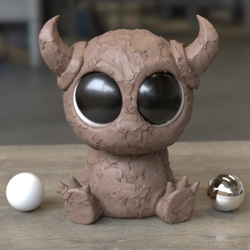

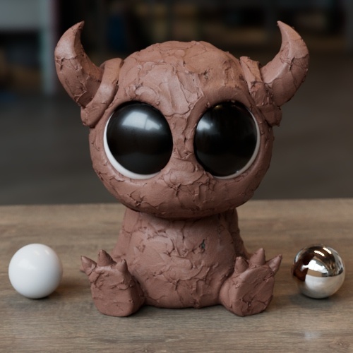

| sRGB | ACES |
This tutorial provides information on how to configure Color Management to work with the OpenColorIO implementation of the Academy Color Encoding System (ACES), as well as a summary of what ACES is. The article is divided into two parts, theoretical and practical. The theoretical part will help you understand some of the basics of ACES, and how it works, before you get down to the practical part, and consider some of the nuances in setting up Color Management.

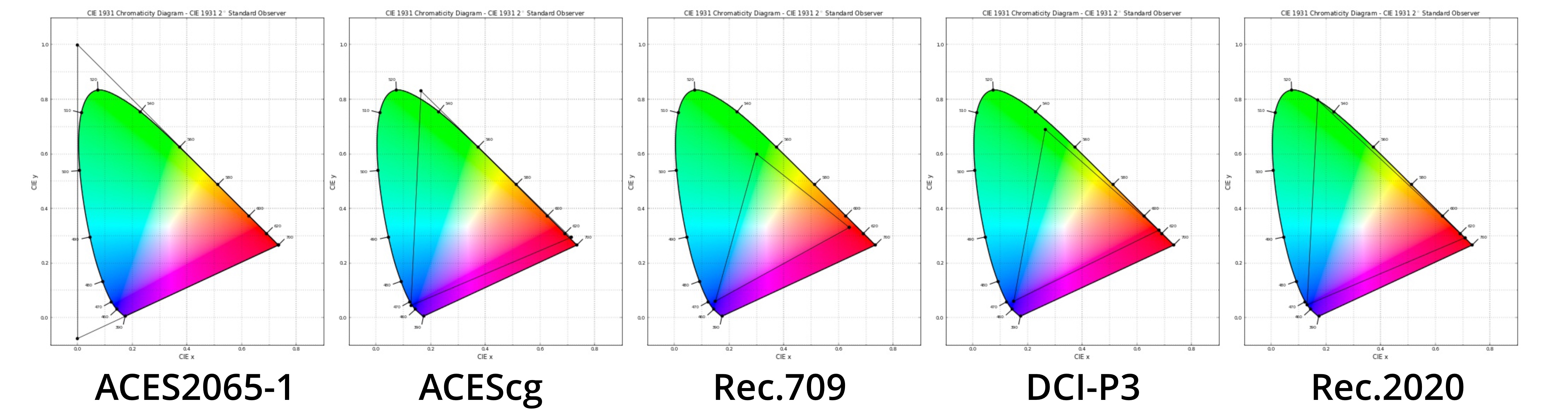

Gamut comparison (image courtesy of Haarm-Pieter Duiker and Thomas Mansencal)
ACES contains different color spaces, we will look at the main ones:
ACES 2065- 1 - This is a wide-range Linear, color space, with a larger coverage than the human eye, so it is used for archival copies and transfer of material between departments. ACEScc and ACEScct - Logarithmic color spaces intended for color correction. ACEScg - This is a Linear space for working with CG/VFX. This is the space you need to use as the main color space for working with color set-up and light in your rendered images. More information is available here.

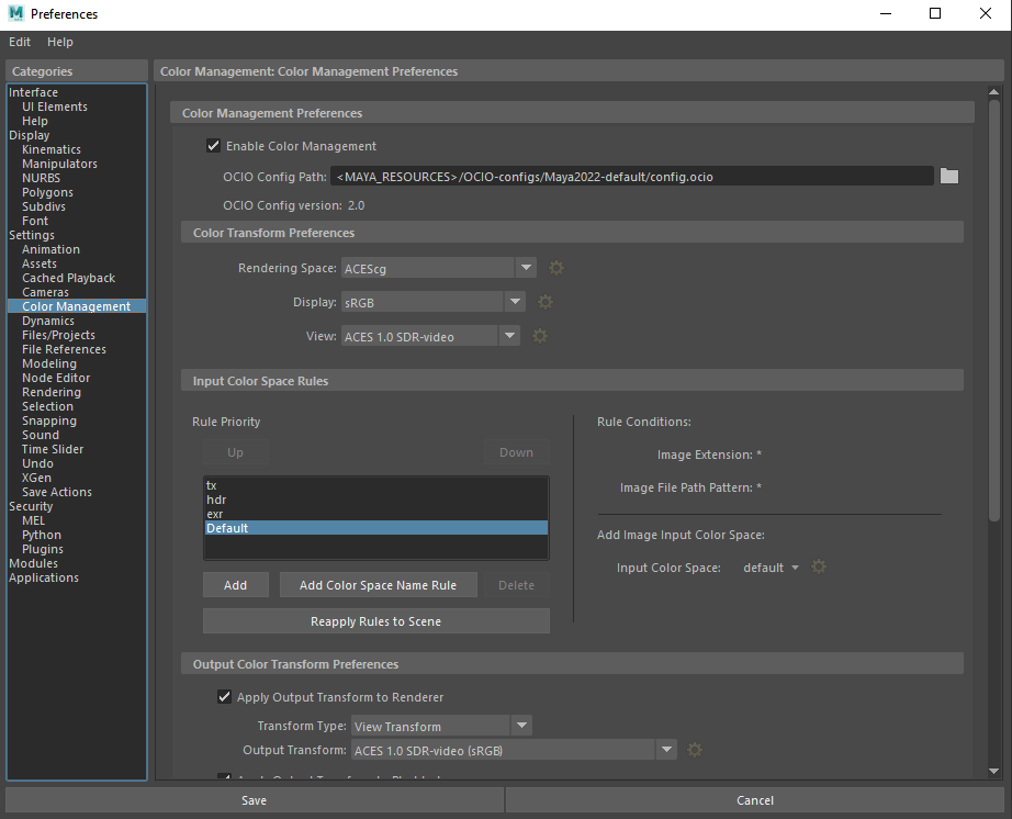

- Start Maya and create a New Project. Open the Preferences window (Windows-> Settings/Preferences-> Preferences). Go to the Color Management settings.
Color Management Preferences
Set the path to config.ocio at OCIO Config Path
Enable Use OCIO Configuration
Set Transform Preferences
Rendering Space ACES - ACEScg.
Set the View Transform option based on the discussion above in section ACES Output Transform Choices. For example: "sRGB (ACES)".
Define Color Space Rules
Go to the Input Color Space Rules in Preferences to configure the default color space assigned to textures. You can use the Add Color Space Name Rule button if your workflow involves putting a color space name (from the config) somewhere in the file path. Otherwise, you can define other rules based on the file extension or some other aspect of the naming.
Maya 2022 Color Management Preferences
The main color spaces for conversion will be:
Scene-linear Rec.709-sRGB - choose this for Linear images that use the Rec.709 or sRGB primaries/gamut (which are the same). RAW - for images that do not require conversion (scalar masks, Displacement, Roughness). sRGB - recommended color space for sRGB image textures 8-16 bit (JPEG, PNG). ACEScg - Color space for images that are already converted to ACEScg.
When converting images to sRGB, they will become darker than the original. This is normal and gives you the opportunity to work with higher light values without losing contrast.
For all other images, not converted to ACEScg, you will need to individually set up the color space for the Image and File nodes.
Remember, if you create a project with ACEScg as the rendering space, you will need to set the Color Space so that all images get correctly converted to ACEScg. Images in other color spaces will look wrong without conversion.

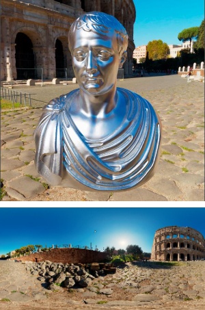

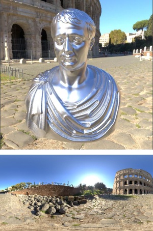

| Linear HDR Map | Linear HDR map opened as ACEScg (incorrect) | Linear HDR map converted to ACEScg (Utility-Linear-Rec.709 or sRGB) (correct) |
