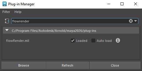

The Flow Render plugin is shipped with MtoA. If the Flow Render menu is not visible in the Arnold menu, load the flowRender plugin by going to the Plug-in Manager (Window > Settings/Preferences > Plug-in Manager). See below.
Flow render plug-in loaded in Maya's Plug-in Manager

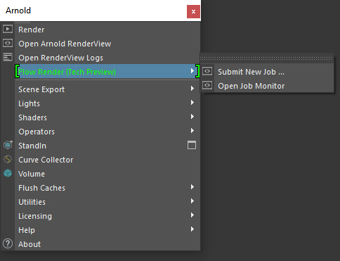

In the Arnold menu, you will then be able to choose between:
- Submit New Job (opens the Flow Render Submitter window).
- Open Job Monitor (opens the Flow Render Monitor window).
Flow render available under the Arnold menu
