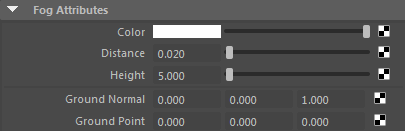

Fog
This atmospheric shader node simulates the effect of light scattering, which causes more distant objects to appear lower in contrast, especially in outdoor environments.
The aiFog node can be found in the atmosphere menu under environment in the Render Settings window.
The aiFog node can also be selected from the outliner ( Show Dag Objects Only must be disabled).
