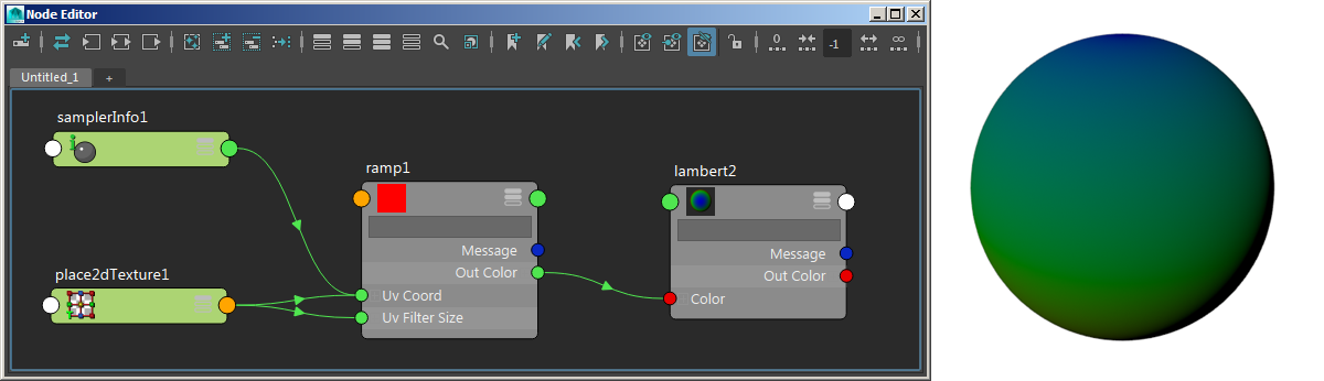

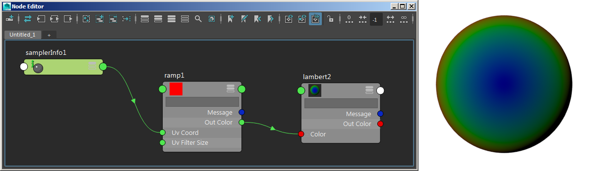

The sampler info facing ratio does not work when connected to the UV co-ordinates of a ramp:
- A workaround is to delete the 2d placement node that is connected to the ramp.
