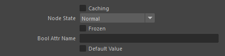

User Data Bool
Bool Attr Name
Default Value

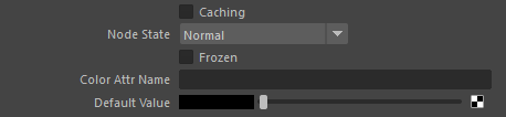

User Data Color
Color Attr Name
Read RGB color from shape user data, at the current shading point on the surface.
Default Value
Output value to use if user data with the specified name is not available.

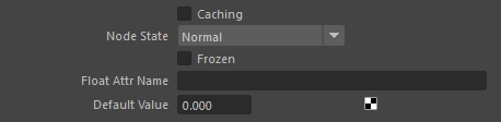

User Data Float
Float Attr Name
Read float value from shape user data , at the current shading point on the surface.
Default Value

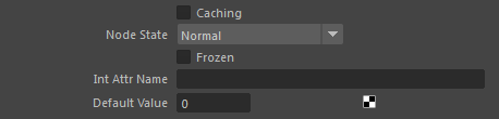

User Data Int!
Int Attr Name
Read integer value from shape user data , at the current shading point on the surface.
Default Value

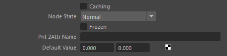

User Data Pnt2
Pnt 2Attr Name
Default Value

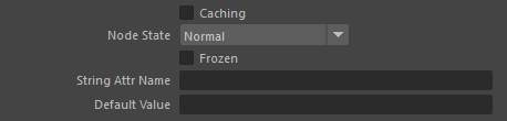

User Data String
String Attr Name
Reads the string from shape user data .
Default Value

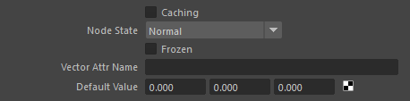

User Data Vector
Vector Attr Name
Default Value...
