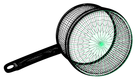

- Select the bottom of the pot and assign a standard surface shader to it. Rename it to 'Base'.
Assign standard surface shader to base of pot

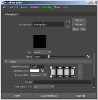

- Connect a ramp rgb to the specular anisotropy parameter.
- Change the ramp rgb type to radial. Insert four black and four white colors into the ramp. Change their interpolation to smooth.
You may notice faceting appears in specular highlights when using anisotropy. It is possible to remove the faceted appearance by enabling smooth tangents for the Arnold attributes of the mesh. Take into account this requires a subdivision iteration of at least one in the polymesh to work.
| No subdivision iterations | subdivision iterations: 1 | subdivision iterations: 1 (smooth tangents enabled) |
The Anisotropic direction is based on the UVs of the mesh you are using.

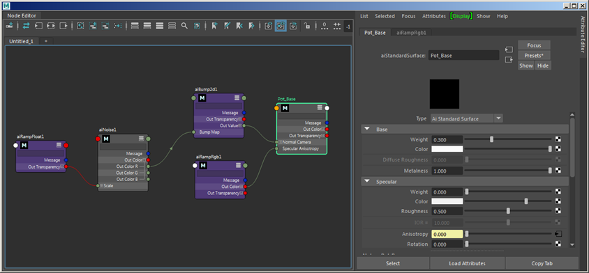

Now we need to create a scratch effect and connect it to the bump attribute to achieve a subtle brushed metal effect. We can do this using the following shaders:
RampFloat -> Noise -> bump2d
- Create a bump2d and connect it to the normal camera of the pots base shader. Set the bump height to around 0.5.
- Create a noise shader and connect it to the bump map of the bump2d. Change octaves to 8 and amplitude to around 0.4.
- Create a rampFloat and connect it to the scale of the noise shader. Change the type to circular. This will give us the concentric ring effect that we want.

Final shading network
