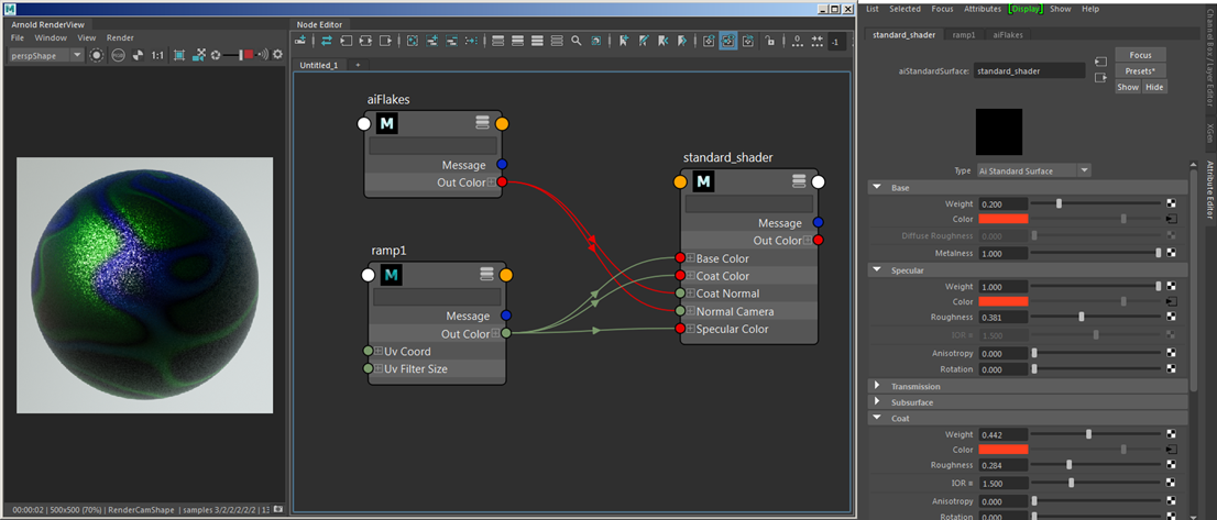

Flakes shader connected to normal_camera of standard surface. Flakes shader coord_space (object) and output_space (world).
