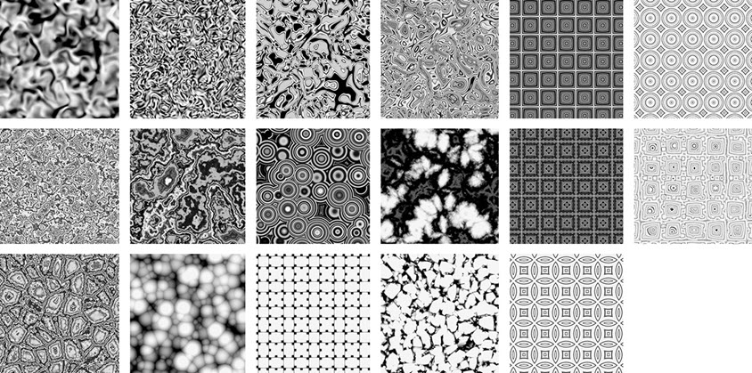

Noise Shaders

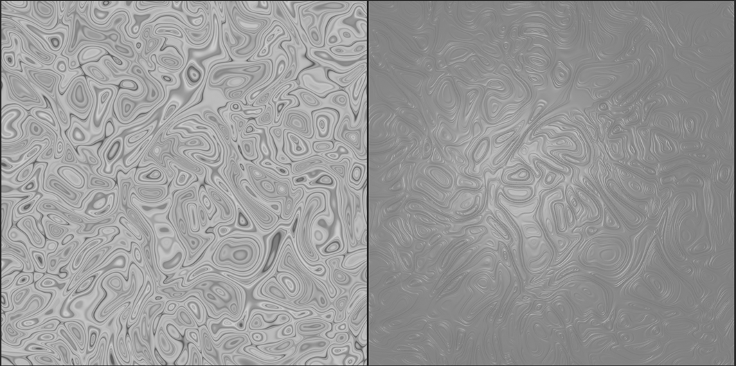

Noise Type 1
Octaves: 1. Distortion: 1.2. Lacunarity: 1. Scale XYZ: 10
Noise Type 2
Octaves: 1. Distortion: 5.2. Lacunarity: 1. Scale XYZ: 10.
Noise Type 3 (Noise x2)
Create a noise shader and set the following parameters:
- Octaves to 1.
- Distortion to 5.
- Lacunarity to 3.25.
- Scale XYZ to 0.
Next, create another noise shader rzits output to the offset parameter of the first Noise shader. Set the following:
- Octaves to 5
- Distortion to 4
- Lacunarity to 1
- Scale XYZ to 5

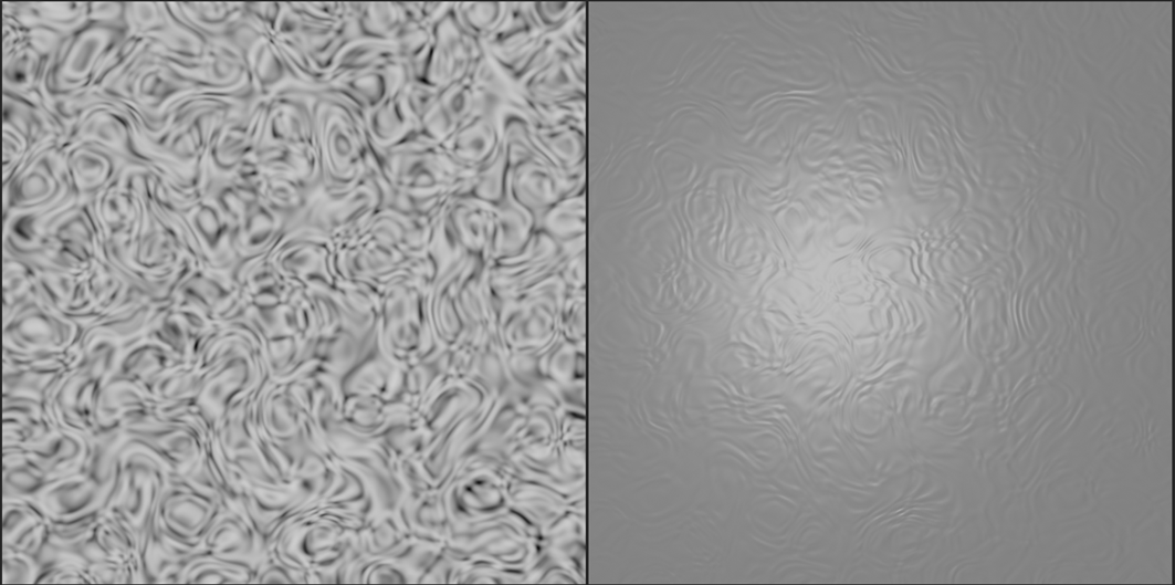

Noise Type 5 (Noise x2)
- Octaves to 1
- Distortion to 6.7
- Lacunarity to 1
- Scale XYZ 5
Next, create another noise shader and connect its output to P parameter of the first noise shader. Set the following:
- Octaves to 4
- Distortion to 0
- Lacunarity to 2.68
- Amplitude 0.719
- Scale XYZ to 10

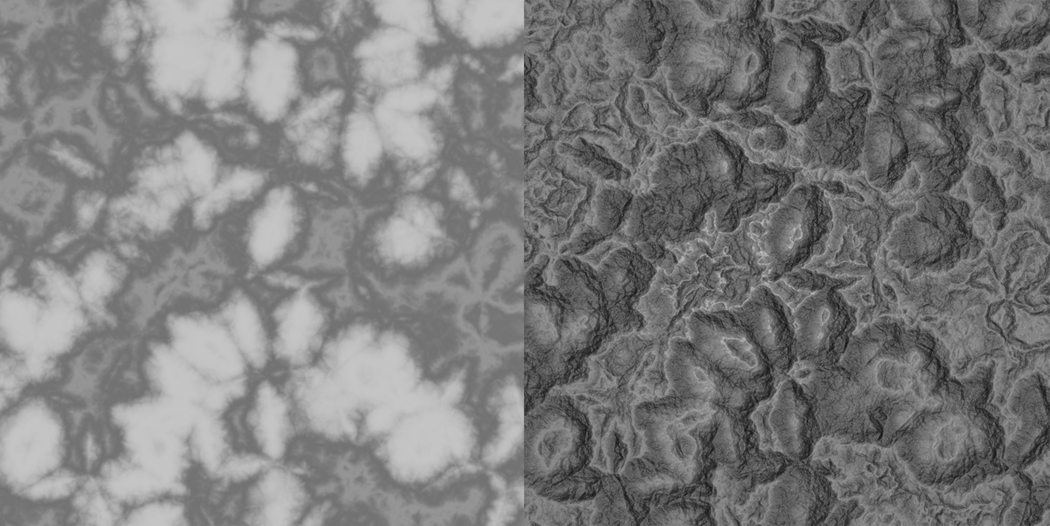

Noise Type 6 (Cell Noise -> Noise)
- Octaves to 1
- Distortion to 3.1
- Lacunarity to 1
- Scale XYZ 6
Next, create a cell noise shader and connect its output to P parameter of the first noise shader. Set the following:
- Octaves to 7
- Lacunarity to 2.806
- Scale XYZ to 7

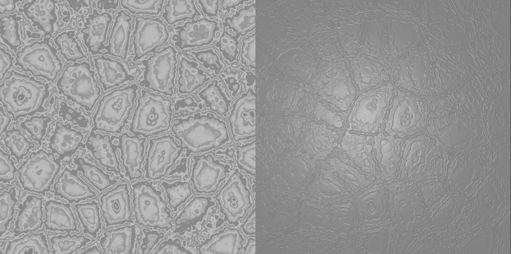

Noise Type 8 (Cell Noise -> Noise)
- Octaves to 1
- Distortion to 3.1
- Lacunarity to 1
- Scale XYZ 6
- Change Pattern to worley2
- Enable Additive
- Octaves to 4
- Lacunarity to 5
- Amplitude to 0.114
- Scale XYZ to 7
- Density to 0.623
- Randomness to 1

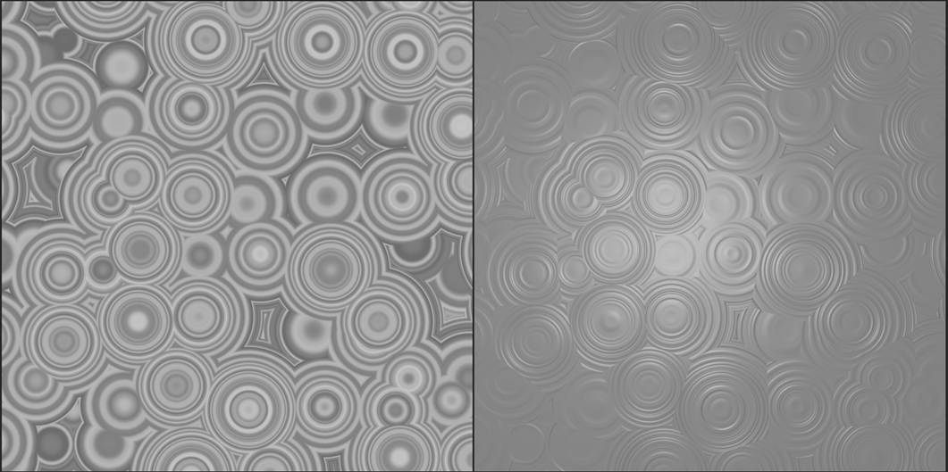

Noise Type 9 (Cell Noise -> Noise)
- Octaves to 1
- Distortion to 3.1
- Lacunarity to 1
- Scale XYZ 6
- Change pattern to alligator
- Enable additive
- Octaves to 1
- Lacunarity to 5
- Amplitude to 0.920
- Scale XYZ to 7
- Density to 0.623
- Randomness to 0

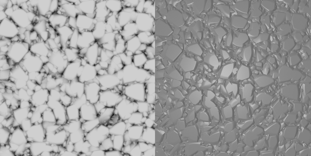

Noise Type 10 (Cell Noise ->Noise)
- Octaves to 1
- Distortion to 3.533
- Lacunarity to 1
- Scale XYZ 6
- Enable additive
- Octaves to 3
- Lacunarity to 5
- Scale XYZ to 7
- Density to 0.549
- Randomness to 0
Noise Type 11 (Cell Noise -> Noise)
- Octaves to 1
- Distortion to 10
- Lacunarity to 1
- Scale XYZ 6
- Turn on Additive
- Set Octaves to 3
- Lacunarity to 5
- Amplitude to 0.177
- Scale XYZ to 7
- Density to 0.549
- Randomness to 1

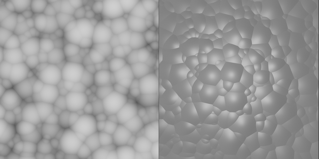

Cell Noise Type 1
Create a cell noise shader and set the following parameters:
- Disable additive
- Set Octaves to 4
- Lacunarity to 1.274
- Scale XYZ 10

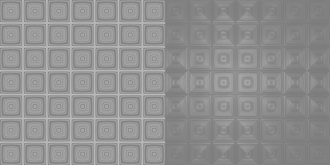

Cell Noise Type 2 (Cell Noise -> Range)
- Disable additive
- Octaves to 2
- Lacunarity to 1.5
- Amplitude to 1
- Scale XYZ to 10
- Density to 0.326
- Randomness to 0
Next, create a range shader and connect the cell noise to its input parameter. Set the following:
- Input Max to 0.343
- Enable Smoothstep

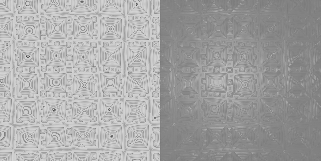

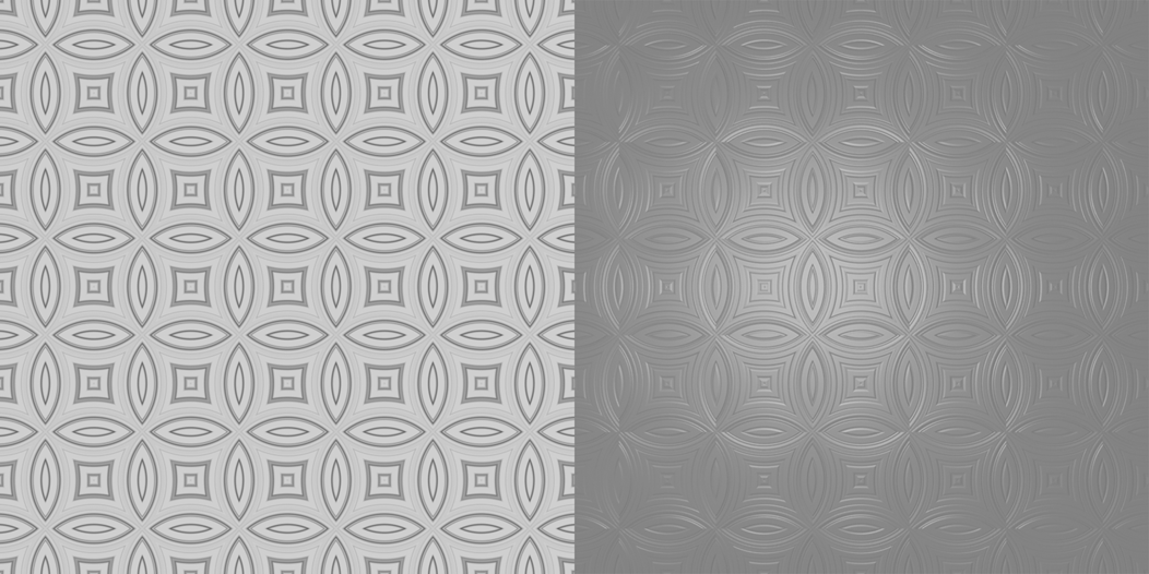

Cell Noise Type 4 (Cell Noise -> Cell Noise -> Range)
- Enable additive
- Set Octaves to 3
- Lacunarity to 1.297
- Amplitude to 1
- Scale XYZ to 10
- Density to 0.326
- Randomness to 1
Create another cell noise and connect its output to P parameters of the first cell noise. Set the following:
- Change pattern to worley2
- Enable additive
- Octaves to 3
- Lacunarity to 1
- Amplitude to 1
- Scale XYZ to 6
- Density to 0.5
- Randomness to 0
- input max to 0.343
- Enable smoothstep

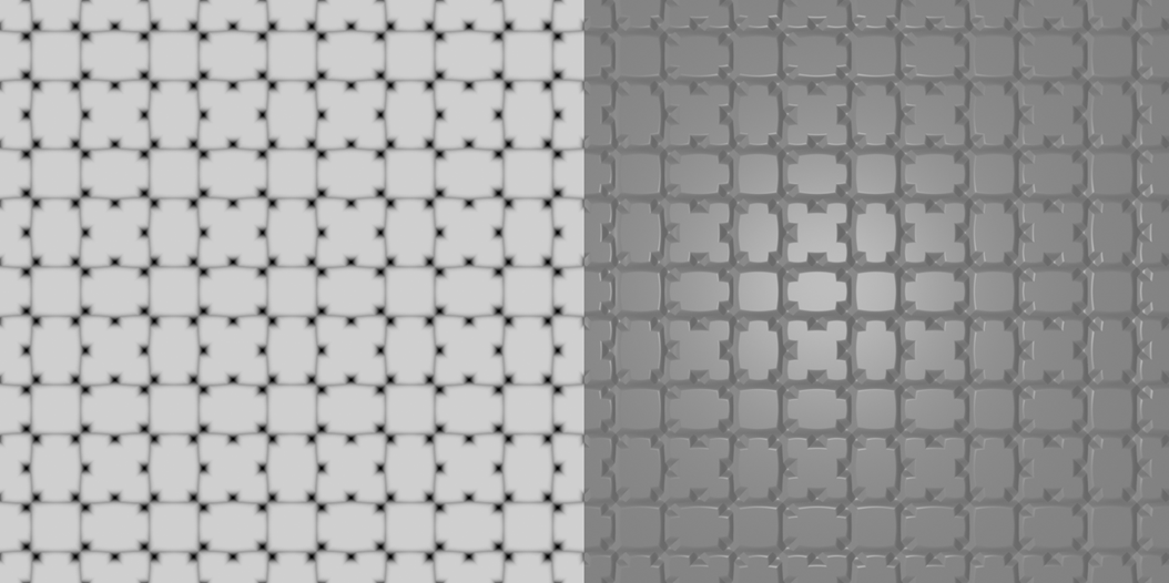

Or set parameters in the second cell noise to get a result like in the image below:
- Change Pattern to worley1
- Disable Additive
- Octaves to 3
- Lacunarity to 1
- Amplitude to 1
- Scale XYZ to 6
- Density to 0.5
- Randomness to 0
Or set parameters in the second cell_noise to get a result like in the image below:
- Disable additive
- Octaves to 2
- Lacunarity to 2.189
- Amplitude to 1
- Scale XYZ to 6
- Density to 0.5
- Randomness to 0.183
