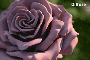

Shading
The rose's standard surface shader has a base color, specular, and SSS maps connected to it. A slightly modified duplicate color map has also been connected to the subsurface color attribute. The backlighting effect is achieved by enabling thin walled.
The animated gif below shows the effect that diffuse (base color), specular (with high specular roughness) and subsurface (SSS) scattering have on the look of the rose. The scene is lit with a directional light pointing towards the camera, thereby creating the translucent backlighting effect and a skydome light with a sky HDR map connected to it its color attribute.

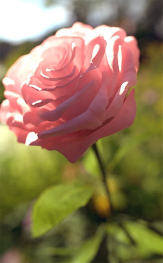

Translucency
SSS combined with thin walled can replicate the effect of a translucent object being lit from behind (bear in mind this effect is more suited to single-sided objects). The images below show the difference when rendering the petal with increasing amounts of thickness. A fly model has been placed behind the petal, and the directional light is pointing towards the camera for maximum effect.
It is generally recommended that thin walled only be used with thin objects (single-sided geometry) as objects with thickness may render incorrectly. However, in this situation, it works fine with thickness (ensure that the diffuse ray depth level is above 1).

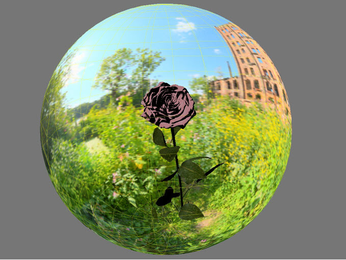

Lighting
An HDRI is connected to the skydome light color. The HDRI used in this example has been downloaded from www.hdrlabs.com. A directional light has also been used to add more sunlight into the scene.
Scene lit with a directional light and a sky shader with an HDR map

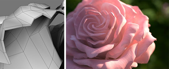

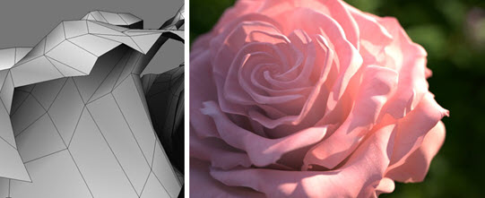

Shadow Terminator
Lighting the scene from behind with a strong directional light has introduced some artifacts at the shadow terminator. The current algorithm enabled by shadow_terminator_fix works well for convex surfaces like a sphere, but it can't fix self-shadowing in concave regions. There are ways to work around this.
Shadow Angle
Increasing the radius of the light (in this case angle because a directional light has been used for the sun) helps to reduce the effect of the shadow terminator (by softening the shadow). However, even when increasing the Angle to high amounts, the shadow terminator will still be apparent.
| Shadow angle: 0 | Shadow angle: 4 |
Subdivision Iterations
Another solution is to increase the number of subdivision iterations of the petal geometry. The artifacts will become smaller.
| No subdivision | Subdivision iterations: 2 |
Extruded thickness
A better, more 'physically accurate' method is to add a small amount of thickness to the geometry by extruding the petals. The image on the left has petals that are only single-sided. When rendered, the petals appear paper-thin (more noticeable around the backscattered areas of the petals). The image on the right shows the results when the petals have extruded depth. The petals now appear to have some thickness when rendered.
Single sided (mesh has no thickness).
Mesh has extruded thickness
