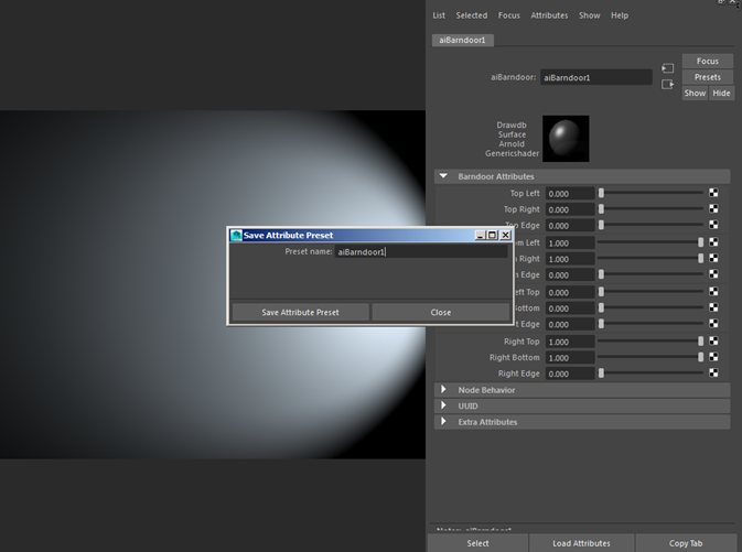

  • Before we start adjusting some of the barn door flaps, create a Preset in the attribute editor for the barn door and call it Ai Barndoor_default. You will then be able to go back to the default preset values of the barndoor. This will make it easier for testing the various values. Create an IPR render of your render camera.
Create a default preset for the Ai Barndoor

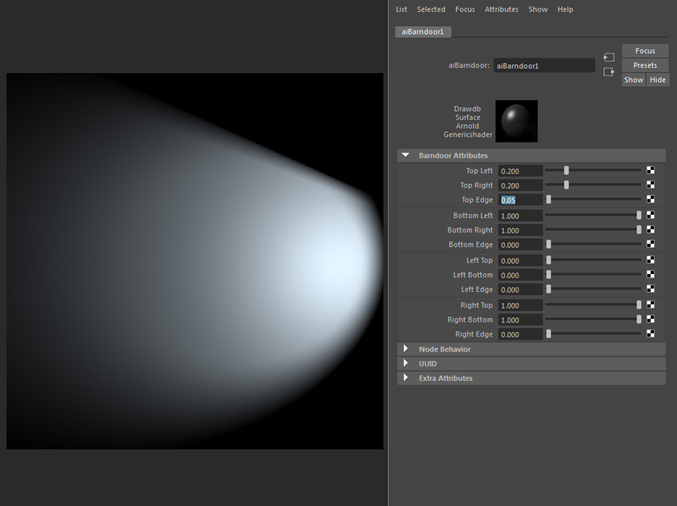

  • Now that we are happy with the position of the top flap, let us increase the top edge slightly to 0.05. Notice how it softens the effect of the top barn door. Now we can repeat this effect for the Bottom flap.
Top edge

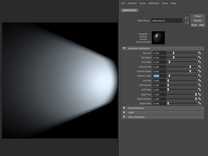

  • The bottom values, however, start from 1.0. To position them equally to the top flap reduce the bottom left and bottom right values to 0.8. Use the same value that we used for the bottom edge, that we used for the top edge to 0.05.
Bottom Left and Right

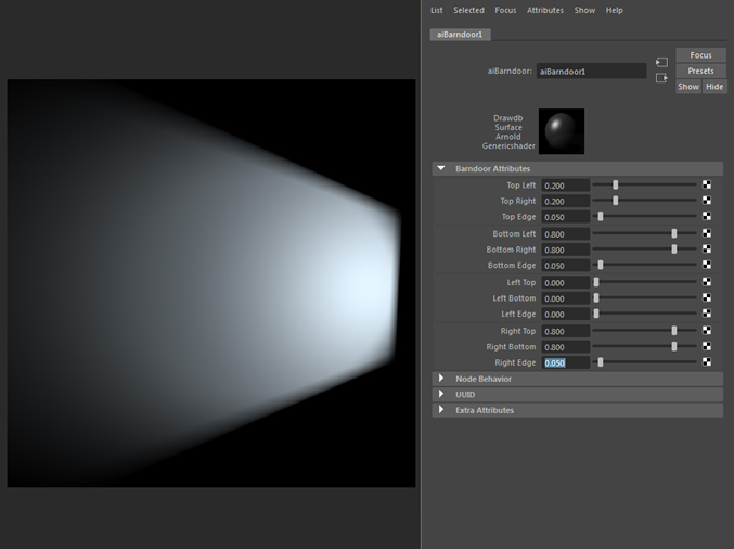

  • We now want to square off the Right edge of our spot light. Repeat the above steps for the right barn door at the bottom.
Right barndoor

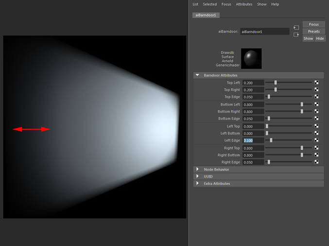

  • We can control how much light appears on the left side of the screen using the left barn door. Increase the left top and left bottom values to 0.2. To pull the light in even more, we could increase these values even further. However, we do not want a hard edge. Instead, we can increase the left edge to 0.1. This has the effect of gently graduating the light as it falls off.
Increase the left edge to soften the left side of the light
