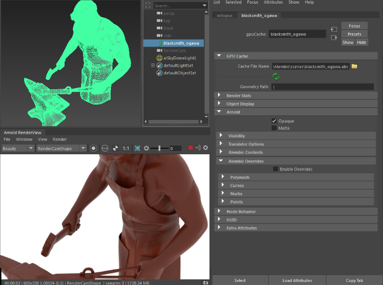

Alembic (.abc) file rendered in MtoA
A procedural node that is capable of reading Alembic files. MtoA supports Alembic (.abc) files via Maya's Pipeline Caching workflow. Information about Arnold's specific attributes can be found below.
Arnold attributes in Alembic GPU Cache

Alembic Contents
Select which objects to display within the Alembic file (changes the "Geometry Path"). The list of contents gets saved to a cache attribute on the gpuCache so the .abc file doesn't need to be read all of the time.
It shows the contents of the file in the Attribute Editor and allows you to apply overrides on the selected items.

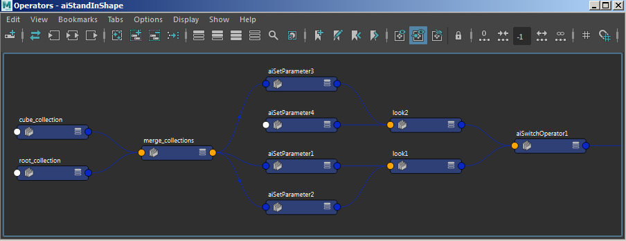

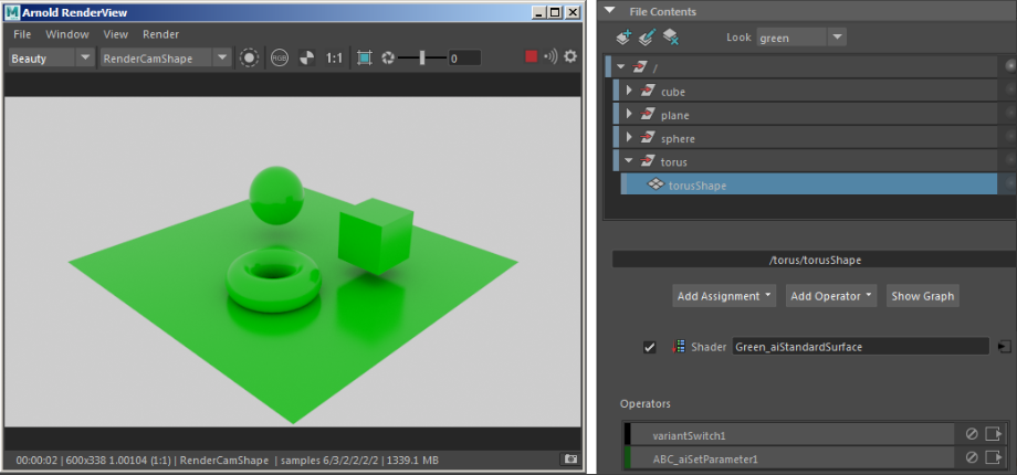

Look
Choose to create, edit or delete look variations. Creating a new look automatically adds an aiLookSwitch node which is a combination of a switch_operator and a merge, which is connected to the root of the procedural graph. When making the first look, the current operators are moved to the first list of inputs on the variant switch node. Labels in the aiLookSwitch are used to populate the menu from the aiStandIn. This plug can be set/overrode by the Render Setup tools for adding different looks per layer/pass. The name/ look /pass will get translated to an index number for rendering.
'Green' look applied

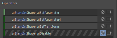

Add Operator
Adds a generic Operator to a point in the Graph. The selection string must refer to the nodes inside the .ass file.
Operator list
