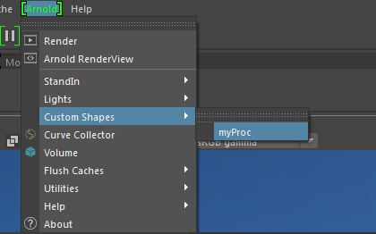

With this setup, MtoA will recognize that this procedural type is a custom procedural that can be created in Maya. It will then appear in the menu "Arnold->Custom Shapes".

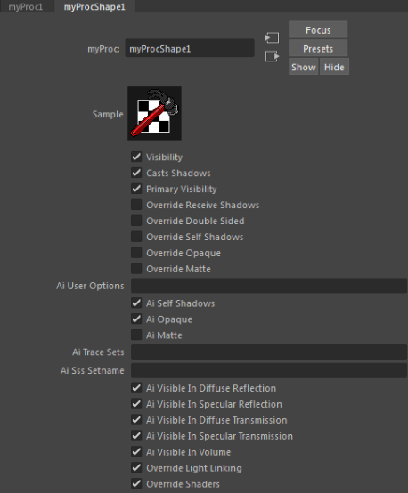

This will create a new node in Maya, containing all the parameters defined in the procedural, as well as the common procedural parameters.
When this node is rendered/exported, all of the procedural attributes will be automatically translated to Arnold.
