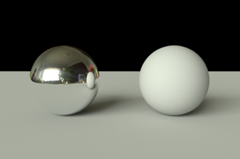

  • To test the effect of the Skydome Light we need to create a simple scene. Create a polygon plane and scale it out to around the size of the grid. Create two polygon spheres and position them on top of the plane.
  • In the Hypershade window create two Standard Surface shaders. Assign one Standard Surface to one sphere and the other to the other sphere.
  • We are now going to the change the second Standard Surface shader to something that resembles a chrome material. Select it and open up the attribute editor. Start off by renaming it to Chrome. Increase the Base Weight to 1. Increase the Metalness to 1 and reduce the Specular Roughness to 0, for a perfectly clear mirror like reflection.
Make one sphere chrome and the other a matte material

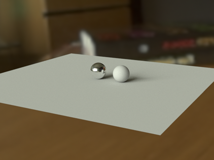

  • Test render the spheres on the plane now. The HDR map that is connected to the Skydome Light should now be visible to the camera. Don't worry if you are getting noisy shadows at this stage. We will refine these later on.
Skydome light visible in background of camera

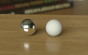

  • Create another Standard Surface shader and assign it to the plane. Rename it "Wood Table". Connect a wood color file texture to the Base Color slot in the attribute editor.

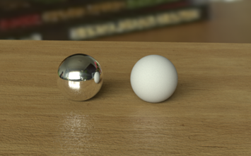

  • Add a specular map to the Specular Color slot in the attribute editor. Now is a good time to start an IPR render in order to fine tune the specular settings of our wood material. Change the Specular Weight value to something like 0.3. You should notice bright specular highlights underneath the spheres in the wood material. Try adjusting the roughness value. Raising the Roughness value will soften the specular highlights and lowering it will make them sharper.
Wood floor texture connected to Standard Surface on poly plane
  • Open up the Bump Mapping and add a 2d Bump File Texture node to it. Adjust the Bump Value to around 0.01. Again use the IPR to interactively adjust the settings.
Add a bump map texture to the Wood shader
