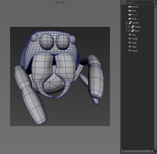

- Start off by loading the spider model. It consists of separated polygon models on which we can apply hair splines.

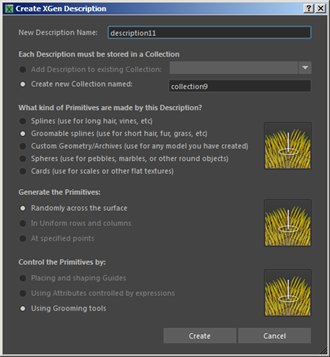

- Select the leg geometry and go to Generate> Create Description. The Create XGen Description window will appear. Choose Groomable splines and click on Create.

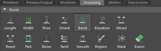

- Go to the Grooming tab and select the Bend brush. In the viewport move the mouse over the leg. You should see that the cursor has changed to the brush tool. Click and drag the brush along the leg from the top to the bottom. You should see that the hairs bend as you brush along them.
| Default length without 'Bend' brush | With 'Bend' brush |
Noise
- The hairs look too uniform. We can break them up by adding some noise to them. Select the Noise brush and repeatedly brush along the hairs.
| Without noise | With 'Noise' brush |

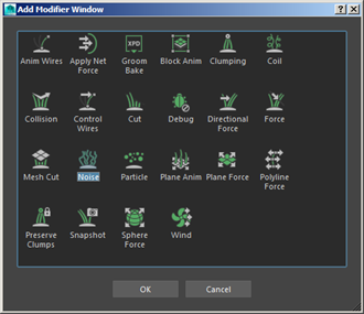

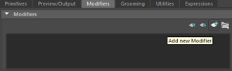

- In order to quickly add some variation to the body description, we can add a modifier to it. Go to the Modifiers tab and Add new Modifier.
- Choose the Noise icon and click OK.
Noise modifier
- Increase the Frequency and Magnitude to get the desired amount of noise. In this case of Frequency of 4 and a Magnitude of 1.3 was used.

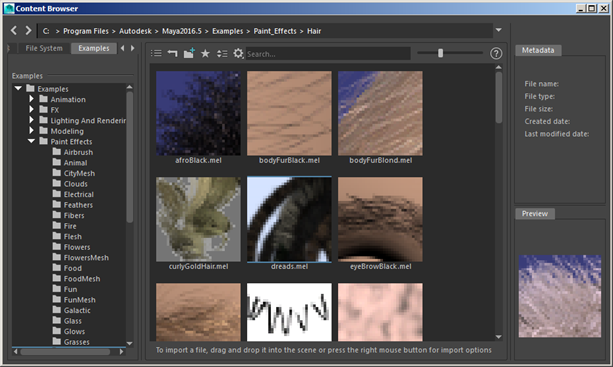

- Open the Content Browser. Select the Paint Effects tab and select the furBunny.mel brush under the hair folder.
Select the 'furBunny' stroke in the Hair folder

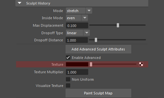

At the moment the curves are looking very symmetrical because we have simply duplicated one group of curves to the other side. One way to reduce the symmetry is to add some noise variation to the curves. The sculpt deformer has an option to deform the curves using a texture map.
- Select the right side group of curves and go to Deform> Sculpt.
- Add a noise texture to the Texture attribute of the Sculpt Deformer. To view the texture in the viewport, you must enable hardware texturing - Shading>Hardware Texturing.

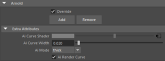

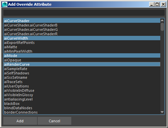

- Open the set in the attribute editor. Under Arnold, select Add. The 'Add Override Attribute' window should appear. Add the following attributes to the set.
- Ai Curve Shader
- Ai Curve Width
- Ai Mode
- Ai Render Curve
Add Override Attributes to Set
- Connect an Ai Hair shader to the Ai Curve Shader attribute.
- Increase the Ai Curve Width to 0.02, depending on how thick you want the curves to look.
- Change the Ai Mode to thick. This will give the curves a round tube profile.
- Select Ai Render Curve for the curves to render.

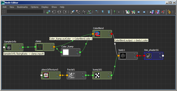

The body
The spider's body has a 'rim shader' assigned to it which gives the impression that the spider is photographed through an electron microscope. A sampler info node is connected to a ramp texture which is assigned to standard_surface.base_color.
Node editor showing body shader of Spider
