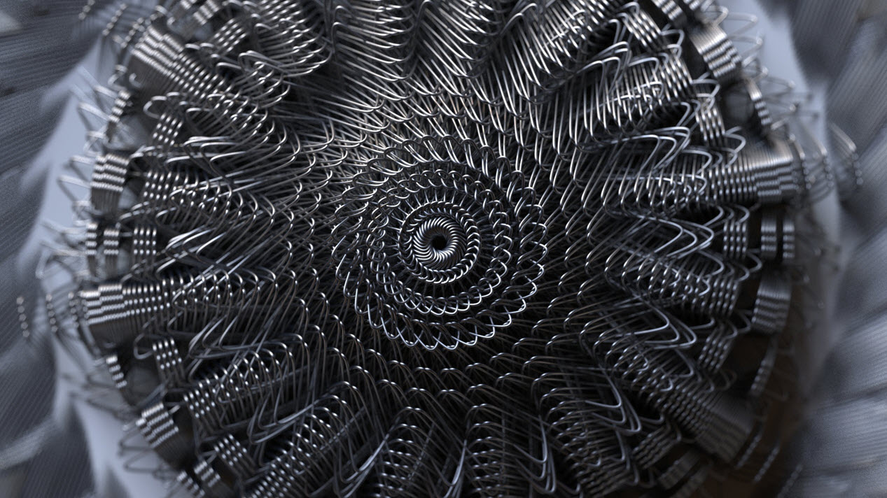

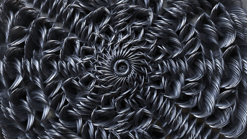

In this short tutorial, we will cover how to use XGen to create some spline patterns that are reminiscent of Mandalas. We will use some of XGen's Spline Primitive attributes to create various patterns such as the example images below. These spline attributes can then be keyframed to create a hypnotic animation. More examples can be found here.

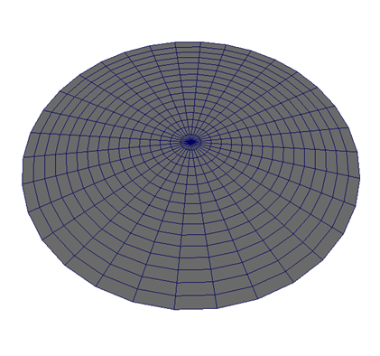

  • Start off by creating a NURBS cylinder. Unparent the top cap and delete the main cylinder shape. We just want the top shape to apply the XGen description.
  • Convert the NURBS top surface to polygon geometry (XGen only works with polygon geometry): Modify -> Convert NURBS to Polygons. Delete the original NURBS surface so that you are left with the converted polygon object as below:
NURBS cylinder top cap converted to polygons

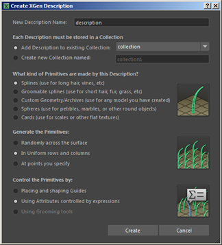

  • With the cylinder top cap geometry selected go to: Generate -> XGen -> Create Description

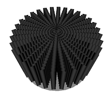

  • Make sure Splines (use for long hair, vines, etc.) is selected. Change Generate the Primitives to In Uniform rows and columns so that they look like the image below.

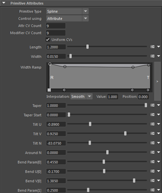

  • In the XGen Editor reduce the Spacing to 0.05. This will create much more Splines on the cylinder on the surface of the topCap geometry.
  • Increase the length of the Splines to around 2.0.
  • Reduce the Spline Width to around 0.1.
  • Increase the Taper to around 1. Taper c ontrols the width at the tip of each spline compared to its base. Positive values make the tip narrower than the base, and negative values make the tip wider than the base.

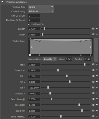

  • Reduce the Bend U value to around -1s. Bend c ontrols how much the spline is bent at the corresponding CV. 0 is no bend, and 1.0 is a 90-degree bend. It should look like the following:

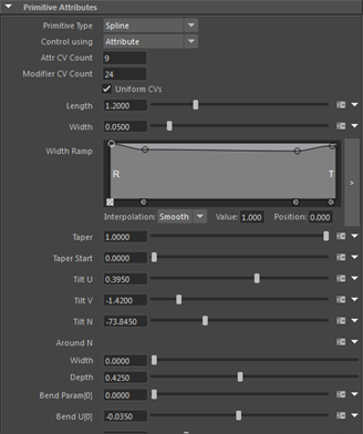

  • Next, try adjusting the Tilt attributes. This attribute t ilts the splines away from the surface normal.
  • Now try adjusting the Bend V attribute. This c ontrols how much the spline is bent at right angles to the corresponding CV. 0 is no bend, and 1.0 is a 90-degree bend.
  • Now we are getting some interesting patterns occurring. Have a go at experimenting with different combinations of these Spline attribute settings to get some interesting and creative results!

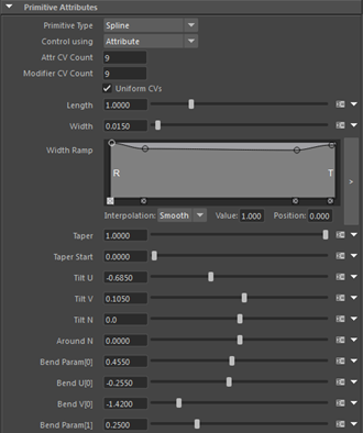

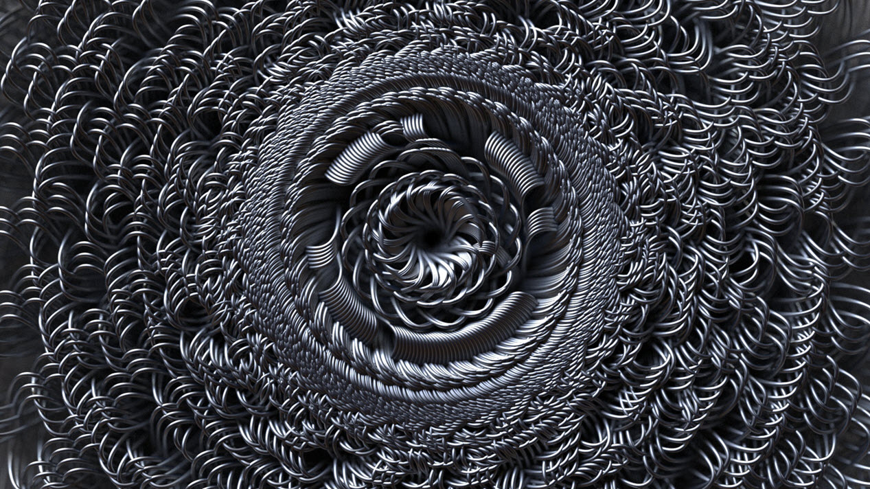

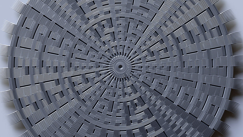

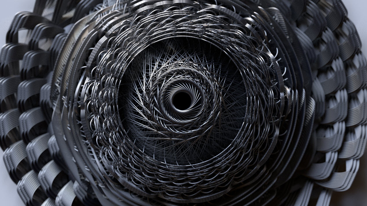

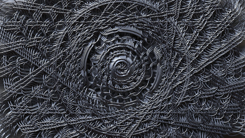

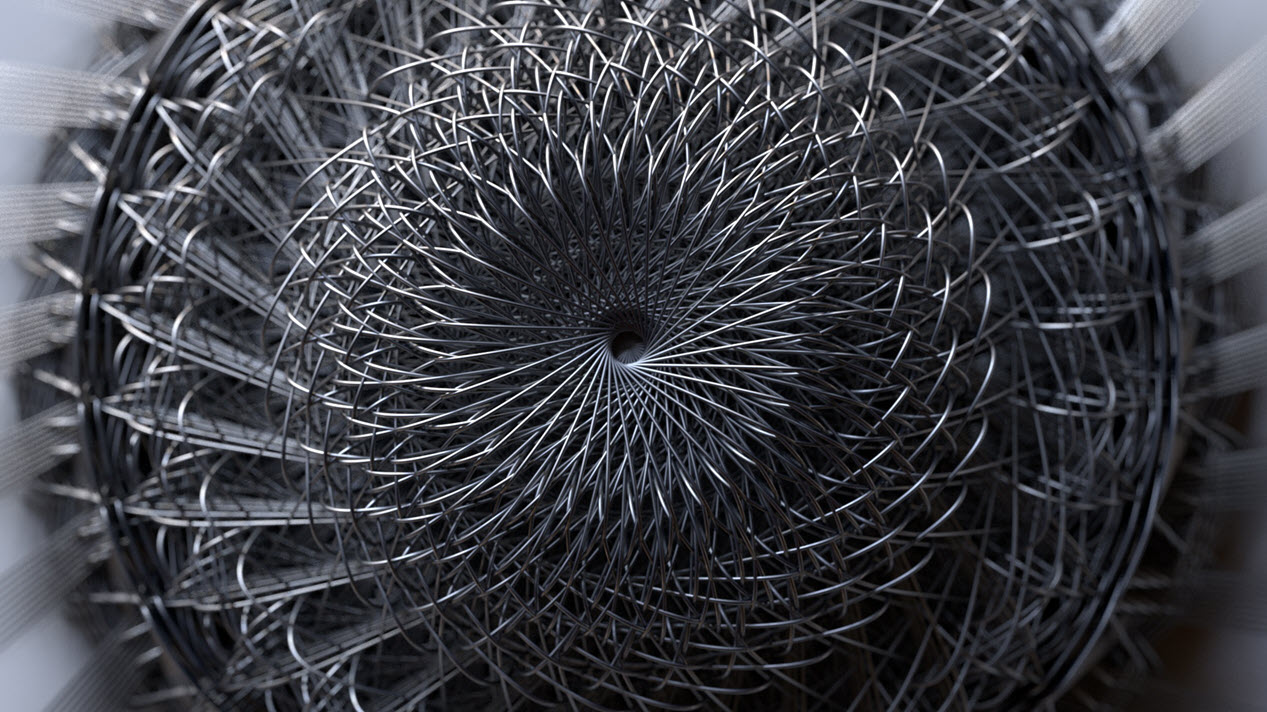

Below are some examples of some finished renders with the XGen Spline Primitive attribute settings below. You can see the wide variety of different looks you can get just by adjusting the Bend and Tilt spline attributes.

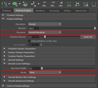

  • Before rendering make sure that Arnold Renderer is set as the Renderer and that the Mode is set to Thick (ribbon is a flat curve which we don't want). These settings can be found under the XGen Preview/Output tab. Assign a shader to the XGen collection, and you are ready to render!
