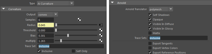

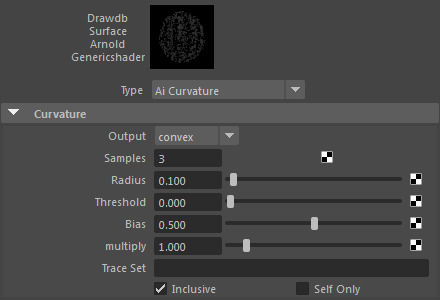

See Curvature in the Arnold User Guide for the full shader documentation.
This shader will sample around the shading point within a given radius to output the curvature. You can adjust the radius, falloff, and spread of the curvature sampling as well as specify a trace set to exclude or include objects. This shader is useful for creating procedural wear or dirt maps in conjunction with a noise shader.
A scene file that demonstrates this shader can be found here.
Note:
A tutorial that covers the curvature shader can be found here.
Trace Set
'inclusive' Trace Set in Arnold attributes and shader
