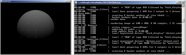

Export Ass and Kick
This option exports the scene as an .ass file, launches Kick, and renders the .ass file in a native render view window outside of Maya as shown below:
Rendering via Kick

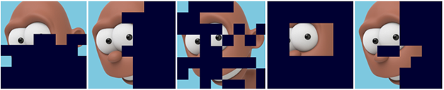

Bucket Scanning
Specifies the spatial order in which the image buckets (threads) will be processed. By default, buckets start in the center of the image and spiral outwards.
Top, Left, Random, Spiral, Hilbert
Bucket Size
The size of the image buckets. The default size is 64x64 pixels, which is a good compromise; bigger buckets use more memory, while smaller buckets may perform redundant computations and filtering and thus render slower but give initial faster feedback.

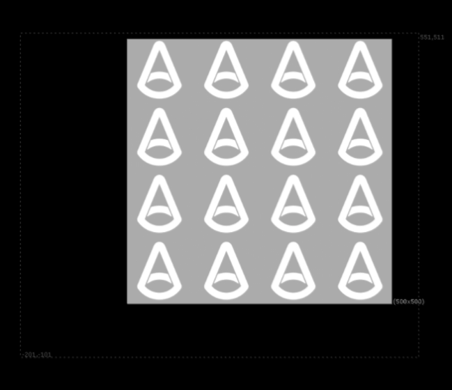

Overscan
Overscan extends the render region beyond the regular image coordinates. It can be either a percentage or a pixel value. You can mix % and pixel values at the same time, however, if you don't specify the unit it will default to pixels. It can have:
  • One value such as 10px to specify an equal margin on every side.
  • Two values, such as 10px 5px, to specify the top/bottom (first value) and right/left (second value) margin.
  • Three values, such as 10px 5px 2px, to specify the top (first value), right/left (second value) and bottom (third value) margin.
  • Four values, such as 10px 5px 2px 1px to specify the top, right, bottom, and left margins respectively.
E.g. a ten-pixel overscan for a 640x480 image in all directions can be achieved with options region_min_x, region_min_y, region_max_x, region_max_y of -10, -10,649, 489. The example below shows a pixel value of 10, 50, 100, 200 (top, right, bottom, left) in the 'Overscan' field:
Overscan set to 10, 50, 100, 200 and the result viewed in Nuke
Tip:
There is a way to view the output image of a render in progress. You must do the following:
  • Set your output to be tiled EXR, zip is fine.
  • Set the bucket scanning method to 'top'.
  • Use a viewer like imf_disp.
Note:
that overscan will only work with batch rendering and the EXR file format.
