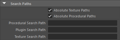

These settings specify the search paths used by MtoA to find plug-ins, procedurals, shaders, and textures.
You can use a colon (:) as a separator (works with Windows, Linux, and OSX). For example:
texture_searchpath "C:/tmp;
[MY_TEXTURE_PATH2]:C:/Users/Documents/maya/projects/Support/sourceimages:
[MY_TEXTURE_ PATH1]"
texture_searchpath "[MY_TEXTURE_PATH1]:
[MY_ TEXTURE_PATH2];C:/Users/Documents/maya/projects/Support/sourceimages: C/:tmp"
Absolute Asset Paths
To export relative paths, clear this checkbox, and put the first part of the absolute path in the Asset Search Path.
Absolute Texture Paths
To export relative paths, clear this checkbox, and put the first part of the absolute path in the Texture Search Path.
For example, if this is the absolute texture path:
then if you put C:\Users\Documents\ProjectDoom in the Texture Search Path and clear Absolute Texture Paths , then this relative path is exported:
If you select a texture using the file browser it will work both with absolute texture paths enabled and disabled. However, if you manually edit the text field it will fail unless you put the image in the sourceimages folder (which is the expected behavior).
Absolute Procedural Paths
To export relative paths for procedurals that load ass files, clear this checkbox, and put the first part of the absolute path in the Procedural Search Path.
For example, if this is the absolute path:
 C:\\Users\\Documents\\ProjectDoom\\ass\\prop.ass
then if you put C:\Users\Documents\ProjectDoom in the Procedural Search Path and clear Absolute Procedural Paths, then this relative path is exported:
 ass\\prop.ass
Procedural Search Paths
Defines a location to search for procedural nodes that load ass files (or obj or ply files).
It is possible to change the pathname of a procedural outside of the main project. MtoA will search for the ass file in both the file path of the stand-in as well as in the path set by the 'Procedural Search Path'. For example, if an ass file is saved in a folder in C:/temp/ass it will also search the subfolders for the ass file.
Plugin Search Path
Defines a location to search for plugins such as shaders, procedural plugins that create new node types, and volume plugins.
For example, if you load ass files from a different plugin, you may need to set the plugin_searchpath to load plugin-specific shaders.
Asset Search Path
Defines a location to search for textures and procedurals. LUTs for the tonemap imager also use this new search path.
