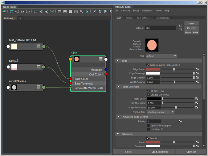

Skin
- Assign a toon shader to the head and body geo and rename it Skin.
- Connect the map test_diffuse
.tif to the base color. - Connect a ramp like the one below to the base tonemap. Ensure it has a darker skin tone for the base tonemap to be visible.
| Without Base Tonemap (default) | Ramp -> Base Tonemap |
- Change the edge color to a brown color.
- Lower the angle threshold to around 80. This will give a pleasing amount of edge detail around the mouth, nose, and chin.
| Angle Threshold: 180 (default) | Angle Threshold: 80 |
Skin Toon shader settings

Silhouette
Now we are almost there. However, the toon edge looks too clean and perfect. We need to break up the edge silhouette to give the impression that it has been hand-drawn.
- Enable silhouette for the dominant shaders such as jeans, boots, stick etc.
- Match the silhouette color to that of the edge color for each shader.
- Create a cell noise shader and connect it to edge-> silhouette-> width scale. Change the pattern to worley1. In this case, the scale has been changed to 0.2. You may want to experiment with different pattern and scale settings depending on the look you are going for. You can also use offset to change the position of the noise along the edge. Attributes such as randomness can have a big impact on the appearance of the edge thickness.
| with cell noise -> silhouette edge | without |
