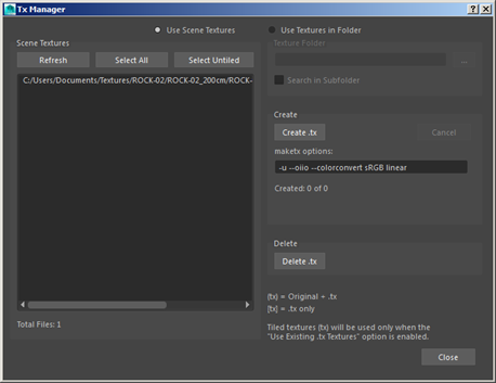

Tx Manager
Textures can also easily be converted to the .tx format using the TX Manager which has an options box that enables you to add parameters to the conversion process.
Tx Manager window with 'maketx --colorconvert sRGB linear' option
