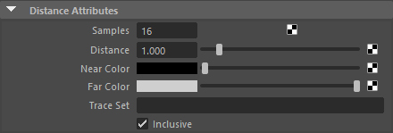

The distance shader uses sample rays to estimate the distance from the shading point to the nearest surface. This distance is mapped to a color linear gradient from near_color to far_color. You can use trace sets to include or exclude objects from the distance measurement.

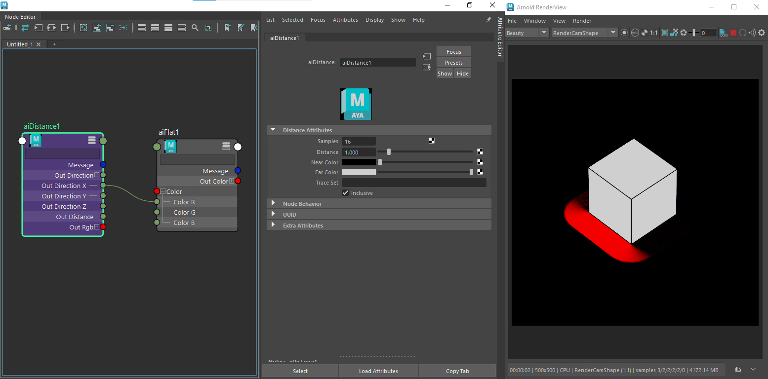

Scene files that demonstrates distance.out_direction can be found here.
distance.out_directionX -> flat.colorR
