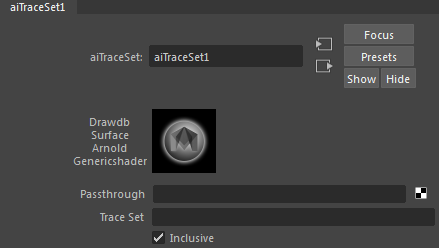

It is possible to designate objects to be part of one or many trace sets. The trace_set shader marks specific rays with an inclusive or exclusive trace set.

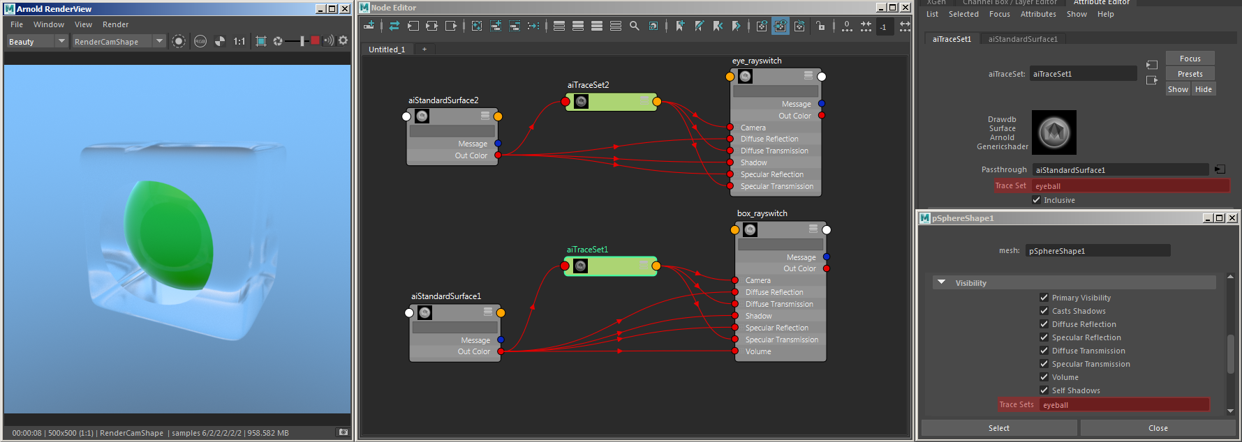

In the Arnold Visibility attributes, it is possible to tag objects to be part of one or many trace sets.
A scene file is available here.
'Eyeball' set in Trace Sets of sphere and shader.
