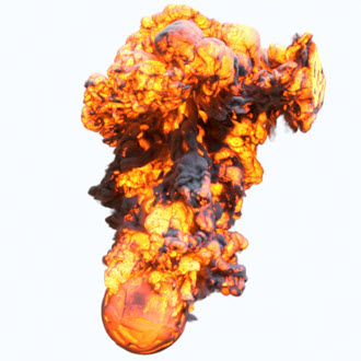

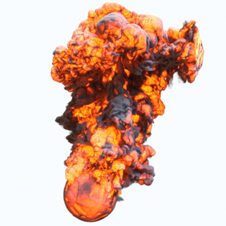

Render the scene. It should look like the following image.

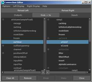

- Break the connection of the 2D texture node to the UV Coordinates in the ramp texture attributes near the bottom.
- Create a volume sample float shader and drag and drop it onto the u attribute of the uv coord as indicated in the image below.
Volume sample float shader connected to Uv Coord (U) attribute
- The Connection Editor will open. Connect the outValue of the volume sample float to the uCoord of the ramp.

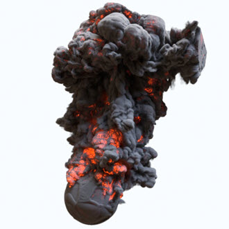

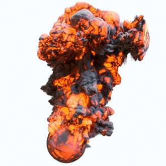

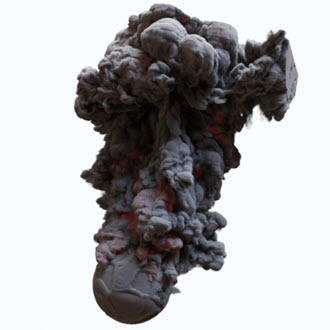

Emission
| 100 | 1000 |
Volume Sample Float Attributes
We can use the volume sample float shader to alter the appearance of the fire. The following images show different adjustment attributes and their effect on the fire volume.
