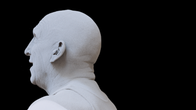

  • First of all, we need to convert the head mesh to a volume. Select the mesh and under its Arnold attributes, increase the step size to 0.1. When the step size is positive, it turns a polymesh into a volume and its value is used as the base step for raymarching the volume.
Note:
More information about volume step size can be found here.
Standard Volume
  • Assign a standard volume shader to the polymesh and increase the density to around 20. This will ensure that the displacement texturing looks more defined later.
Polymesh rendered as a volume

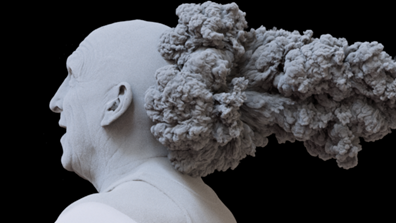

  • Next, place an Arnold Volume at the rear of the head and assign the same standard volume shader to it. In this case, a smoke .vdb file was used.
Alternatively, you could use a different mesh and apply the same shader as the head to it. The aim is to have something that looks complex for the displacement texturing process.
Volume rendered with same standard volume shader

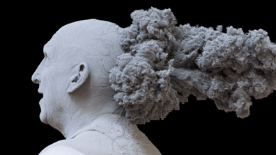

  • Connect a file texture to the displacement attribute of the standard volume shader. In this case, a camera projection has been used. We can see the effect of the texture (mostly on the head), however, we need to make the effect more prominent.
c
Displacement texture is faintly visible

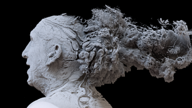

  • We can use a range shader to remap the input values of the file texture to exaggerate the effect. Connect the file texture to the input of the range shader and connect the range shader to the displacement of the standard volume shader. Increase the output max value of the range shader to around 8. You should now start to really see the effect that the file texture has on the volume displacement.
Displacement texture is more obvious due to range shader

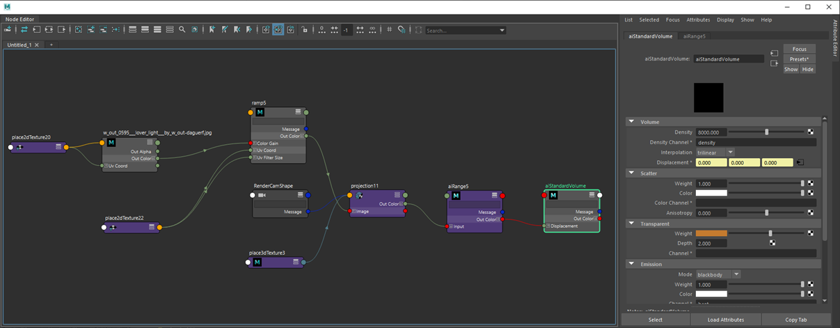

  • Finally, to add some color, you could try connecting the same file texture to the scatter color or transparent weight attributes of the standard volume shader.
Final shading network
