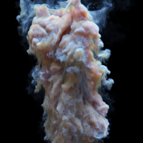

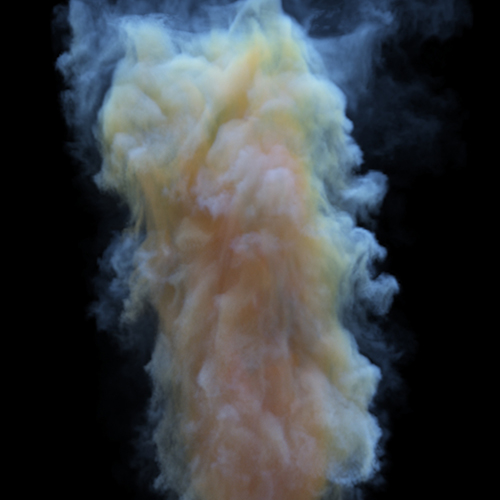

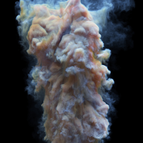

Contrast
| 1 | 2 | 10 |

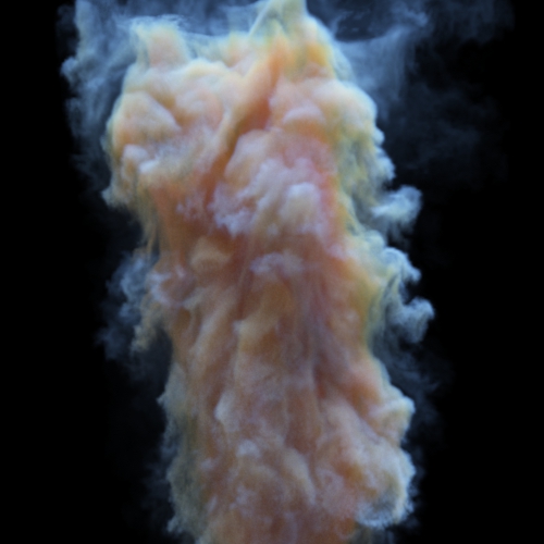

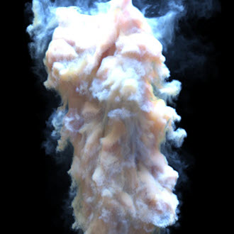

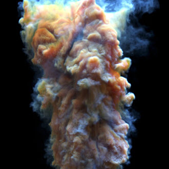

Exposure
| 0 | 1 | 8 |

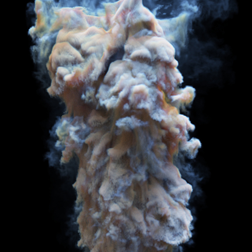

Multiply
| 1 | 10 | 25 |

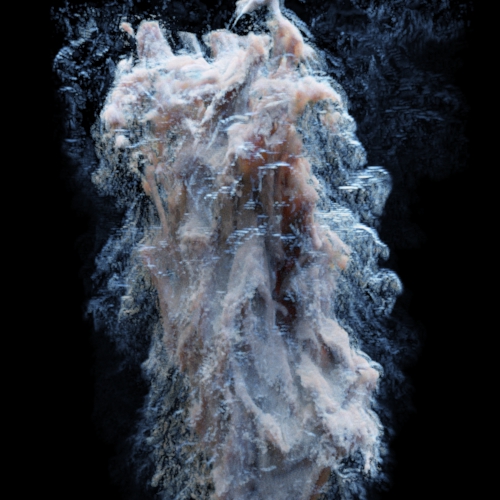

Add
| -5 | 0 | 5 |

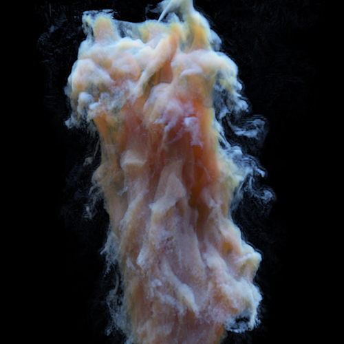

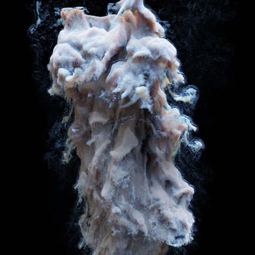

The final corrections used in this example involved adjusting the gamma, exposure, multiply and add attributes as per the image below:
Final attributes for volume sample rgb

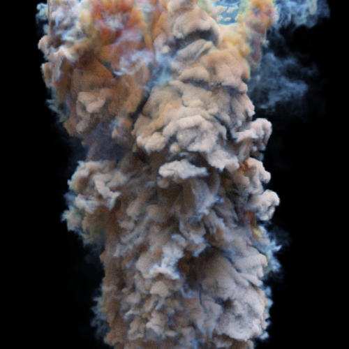

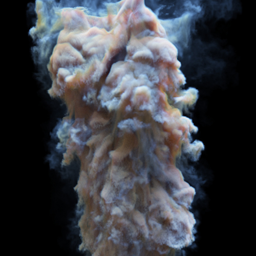

Volume Ray Depth
Increasing the volume ray depth can also have a dramatic affect on the appearance of the volume. Remember to increase the number of volume samples to compensate for any resulting noise. In this example, 6 volume samples was used.
When increasing the volume ray depth, you may need to reduce the exposure of the scene lighting to compensate for the additional multiple scattering of illumination in the volume.
| 0 | 6 |
