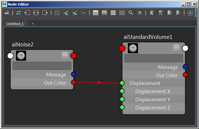

  • Create a standard volume shader and a noise shader. Connect the noise shader to the displacement attribute of the standard volume shader. You may need to increase the density to see the bunny volume.
Noise -> standard volume displacement

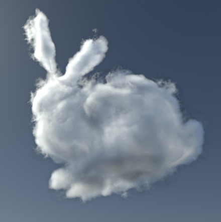

Noise Type Examples
The images below show the effect of using different noise types connected to the standard volume displacement.
Arnold noise Cell noise Perlin noise
