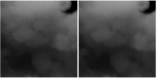

To reduce the amount of noise in a volume, you must ensure that any lights in your scene have sufficient volume_samples, or alternatively that you have enough Camera (AA) samples.
Volume samples: 1 vs 3

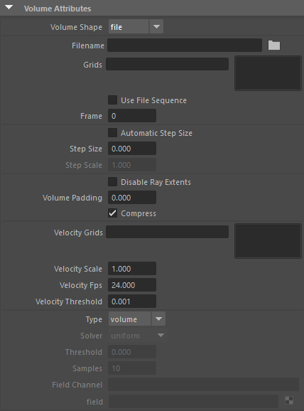

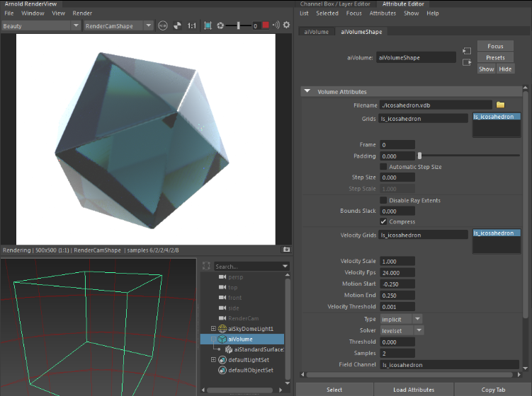

Volume Shape
Set the volume shape to box or sphere (defaults to existing file mode).
Filename
The location of the VDB file.
Ensure that the IPR is not running when updating the file, otherwise, the bounding box will not display at the correct size in the viewport.
Grids

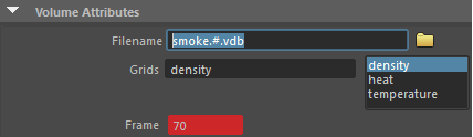

A list of OpenVDB grids to read and make available as channels in the volume shading context. Examples of Grid names are density, fuel, heat, temperature or velocity.
Use File Sequence
Reads a sequence of VDB files.
Frame
Specifies the frame of the sequence to be rendered.
Keframe set for 'Frame' and hashtag used in 'Filename' when using VDB sequence

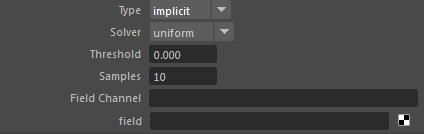

Type
Implicit
Volume implicit nodes can be used to load OpenVDB files for rendering volumes and implicit surfaces respectively.
Implicit type volume .vdb file

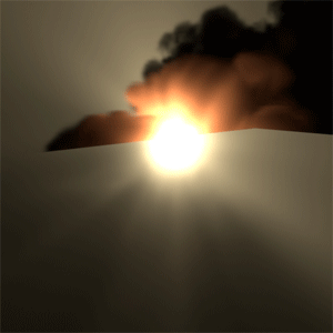

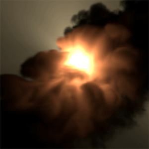

Currently, atmosphere_volume does not compose well against volumes. This is because atmospheres return a single flat result that is opacity mapped on top of whatever is in the background of the pixel.
Left: floor plane geometry hidden. Right: floor plane geometry visible. Fluid renders incorrectly.

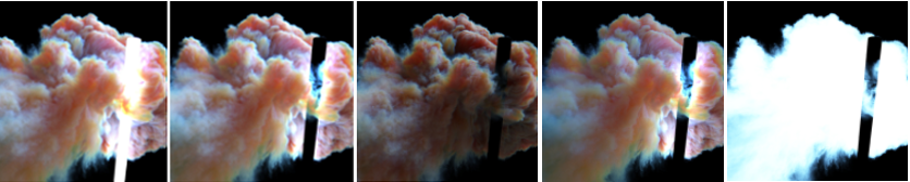

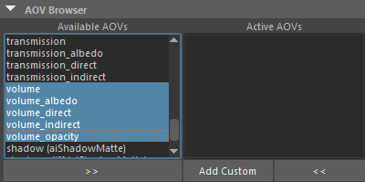

Volume AOVs
A list of available AOVs associated with Volumes. Each option creates a separate AOV render pass for that component.
- volume : beauty AOV that contains volumes.
- volume_albedo : volume albedo.
- volume_direct : direct scattering in volumes.
- volume_indirect : indirect scattering in volumes.
- volume_opacity : RGB AOV with the full three-channel opacity.
beauty, albedo, volume_direct, volume_indirect, volume_opacity.
