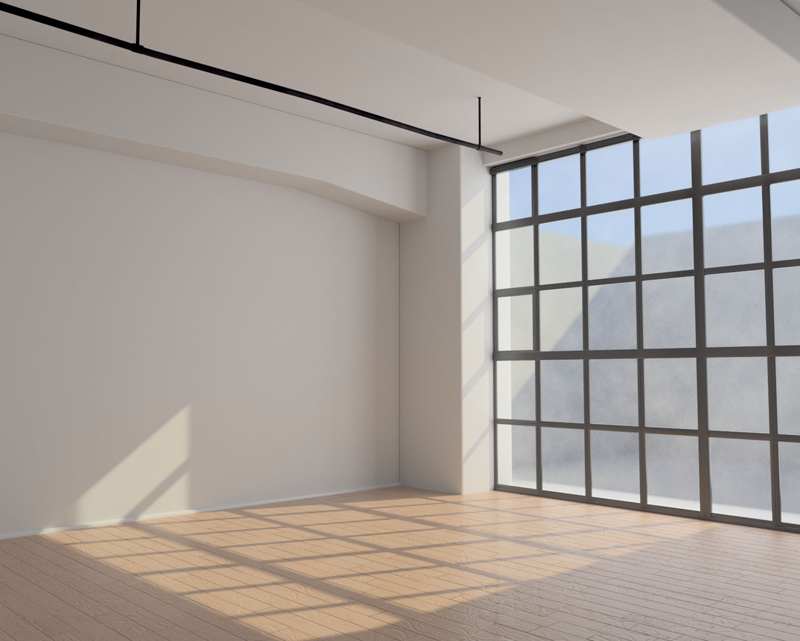

Scene lit with a Physical Sky node connected to a SkyDome light
  • Start off by creating a Physical Sky shader.
  • Create a SkyDomeLight and connect the Physical Sky to the color attribute of the SkyDomeLight.
  • IPR render the scene and adjust the Elevation and Azimuth settings so that the sun is shining through the window and hitting the far right wall and floor. In this case, the Elevation is quite low 15, and the Azimuth has been angled so that the sun light hits the far wall 143.

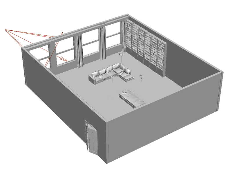

The SkyDome light will not contribute any volume/atmosphere scattering effect. However, we can cheat this by adding a spotlight to the scene
  • Position a Spot Light so that it points through the windows. Rotate it so that it matches the angle of sunlight from the Physical Sky. Be aware that we now have two lights representing sunlight in our scene. This will create two types of shadows which we do not want (the spotlight is only being used to create a volume scattering effect). If this effect is apparent, you could try to disable 'enable_sun' in the Physical Sky shader and use the spotlight to simulate the direct sunlight.
Spotlight pointed through window

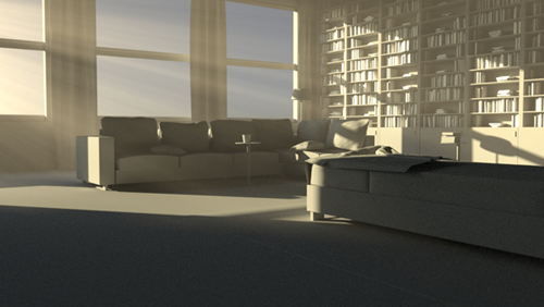

  • Finally, change the Color Temperature of the Spot Light to around 4500 to get a nice warm sun light effect through the windows.
Spot Light with Atmosphere Volume added to scene

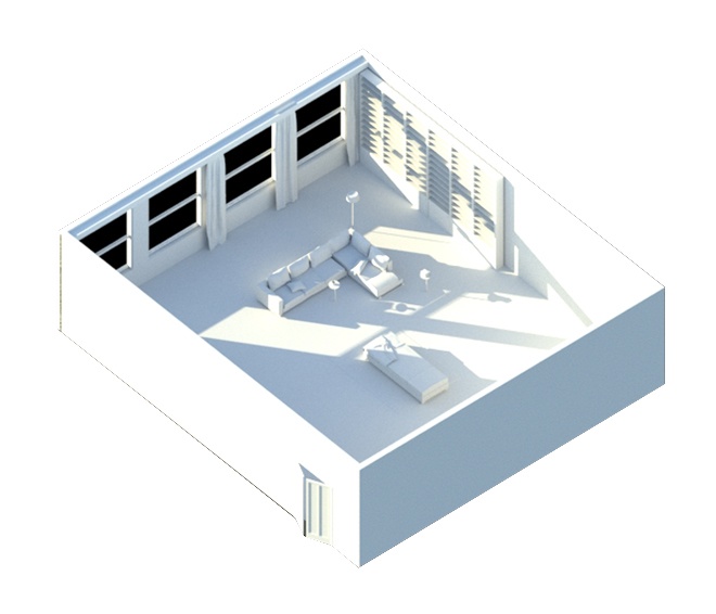

Further example of an interior lit with a Physical Sky -> Sky Dome light
