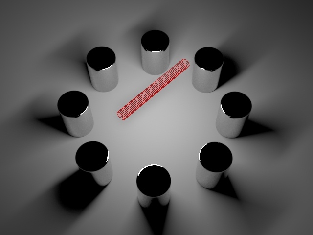

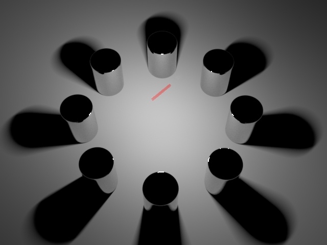

Increasing the size of the Cylinder Light will create a larger area light size and therefore will soften the shadows that run perpendicular to the cylinder’s axis. Cylinder lights will always be circular. It is not possible to scale the width to create an ellipse.
| Cylinder light scaled up | Cylinder light scaled down |
