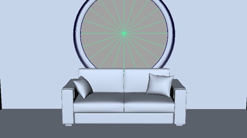

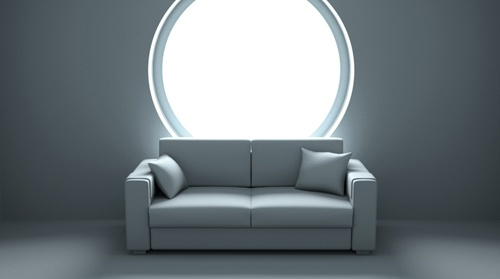

The disk light shape simulates light from a circular area source (flat disk).

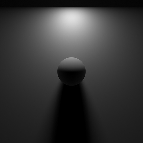

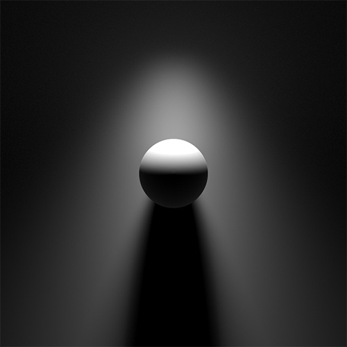

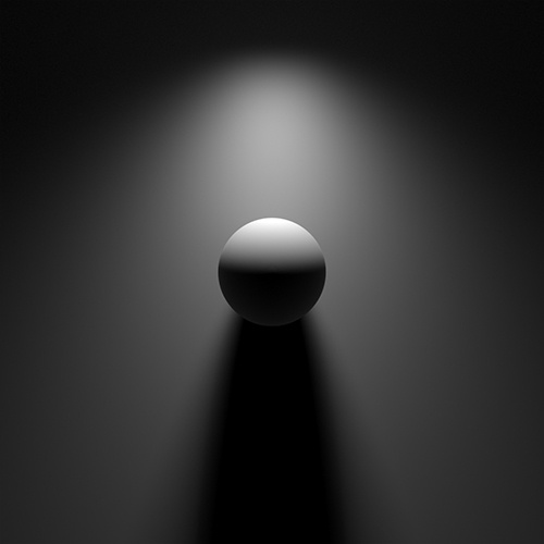

Emits light focused in the direction along the normal. The default Spread value of 1 gives diffuse emission, while lower values focus the light more until it becomes almost a laser-like beam at value 0. Currently, fully focused laser beams at value 0 are not supported; there is always a small minimum Spread. Low Spread values can be noisier than the default high Spread, so be careful when using them.
| 1 (default) | 0.3 | 0.2 |
