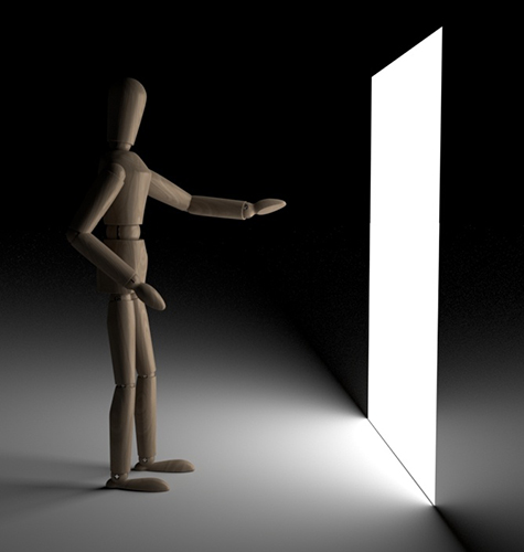

Simulates light from an area source (a quadrilateral, specified by four vertices). It can be used to model light from an extended source (fluorescent strip lights) or, in some circumstances, from a window.

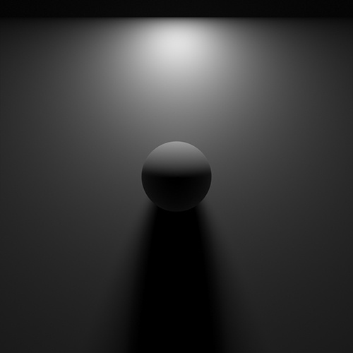

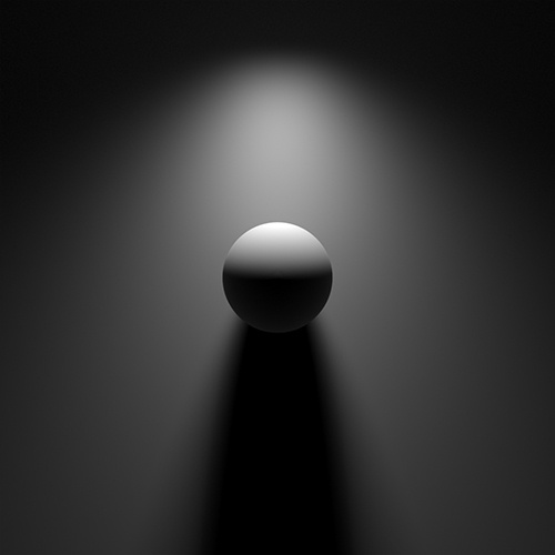

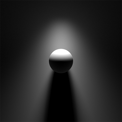

Spread
Emits light focused in the direction along the normal. The default Spread value of 1 gives diffuse emission, while lower values focus the light more until it becomes almost a laser-like beam at value 0. Currently, fully focused laser beams at value 0 are not supported; there is always a small minimum Spread. Low Spread values can be noisier than the default high Spread, so be careful when using them.
| 1 (default) | 0.3 | 0.2 |
The animation below shows the effect when lowering the spread value.
Spread value lowered from 1 (quad light

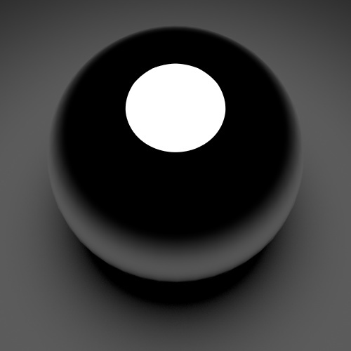

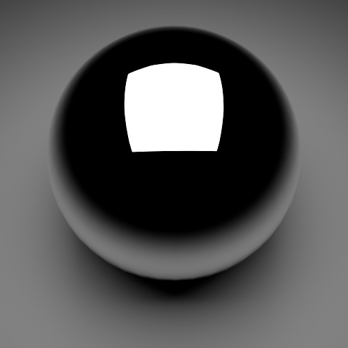

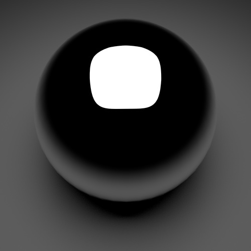

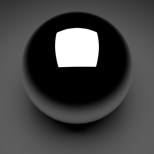

Roundness
Changes the shape of the light from a square at 0, to rounded corners, to a disk at 1.
| 0 (default) | 0.5 | 1 |

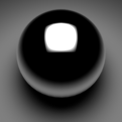

Soft Edge
Specifies a smooth falloff for the edges of the light. The value specifies the width of the soft edge, from no soft edge at 0, to smooth falloff all the way to the light center at 1. Works similarly to the Penumbra Angle for spot lights.
| 0 (default) | 1 |
