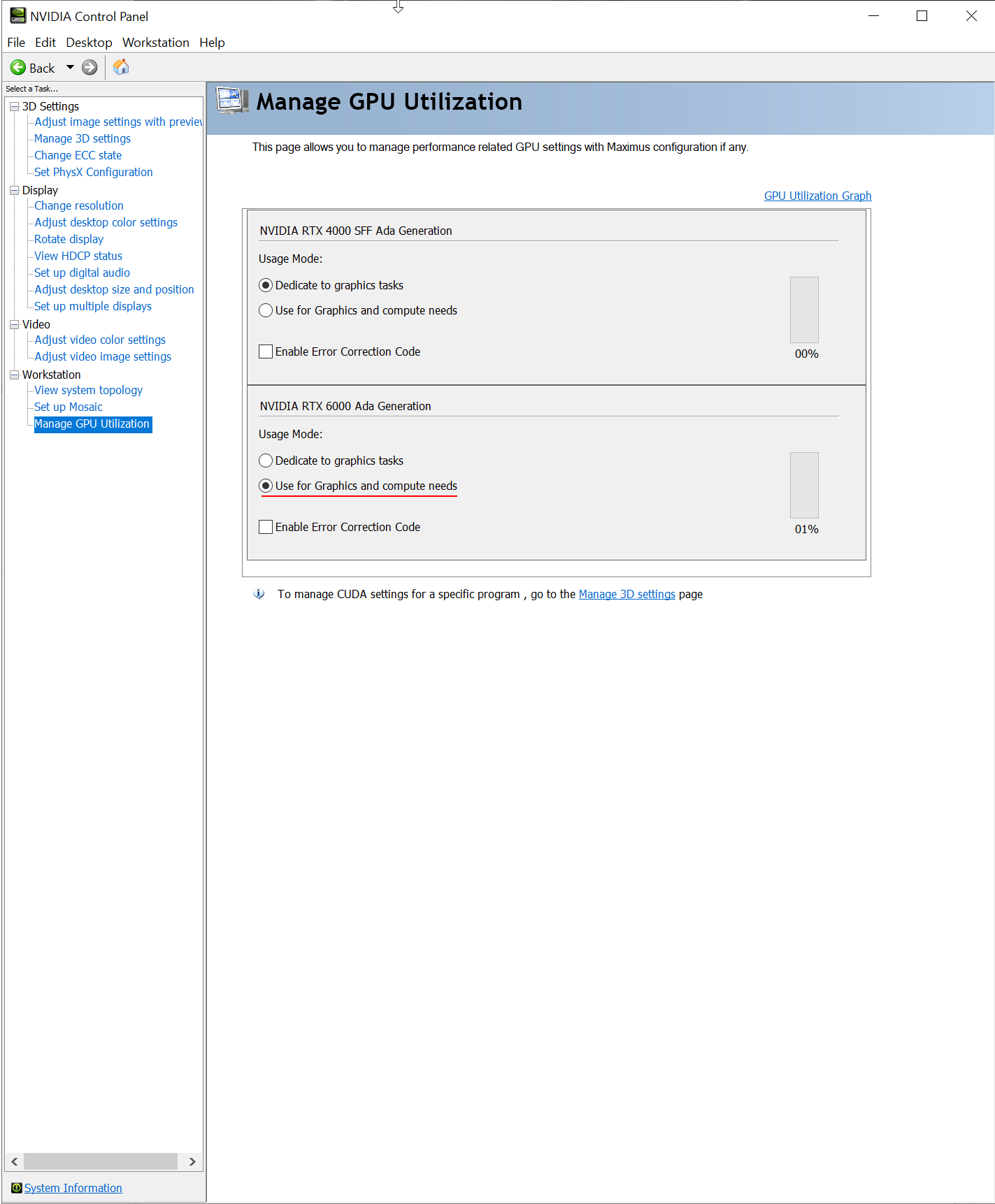

I installed a second GPU on my machine, but I don't see it listed in the Render Settings. Shouldn't it be recognized automatically?
When installing a GPU card, it is possible that Windows may make the GPU invisible to Arnold and other CUDA programs by marking it as dedicated to graphics. This can be adjusted in the Manage GPU Utilization section of the NVIDIA Control Panel (enable Use for Graphics and compute needs).
