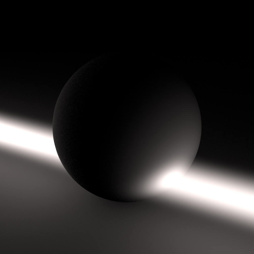

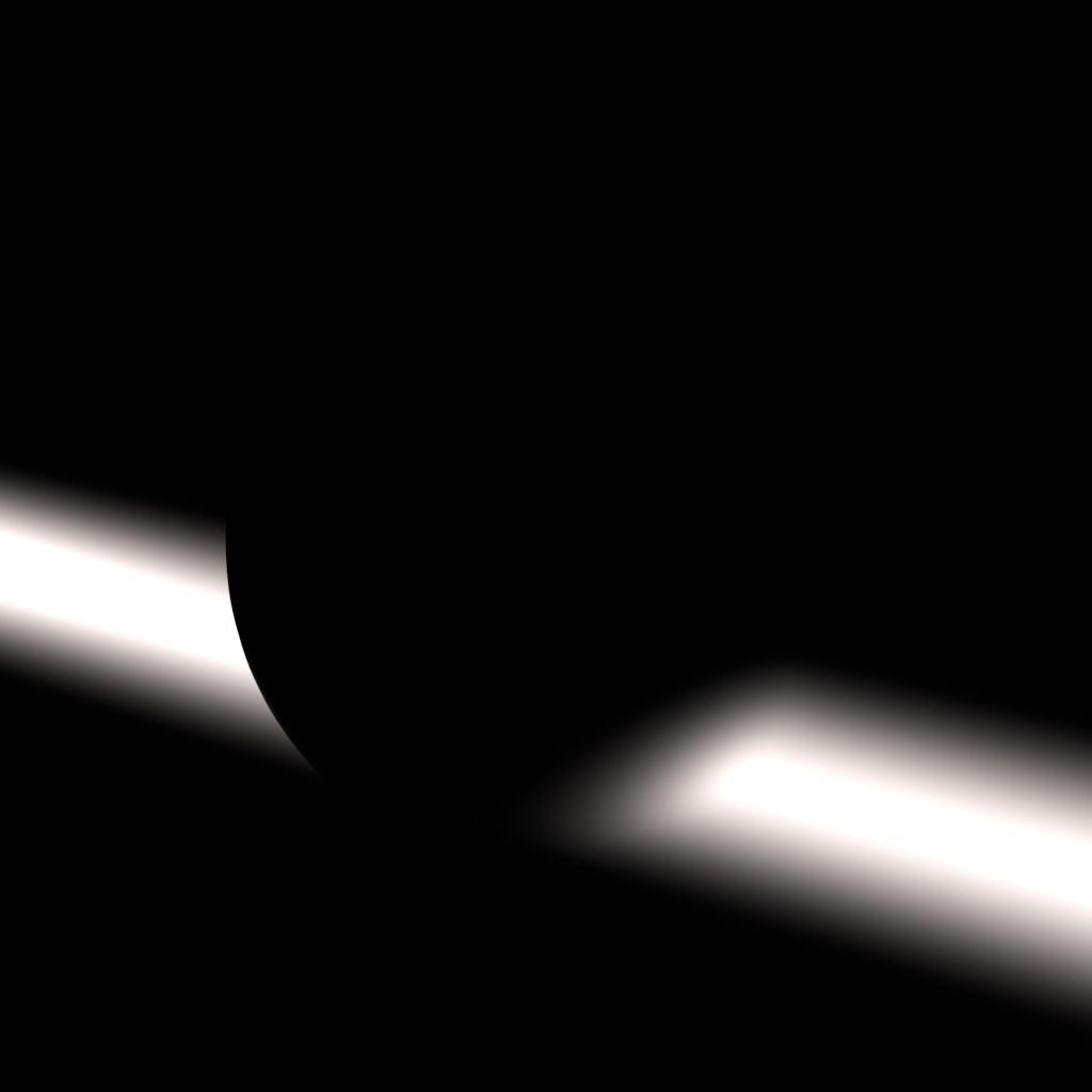

Diffuse
Controls the degree to which Atmosphere Volume affects diffuse rays.
| 0 (default) | 1 |

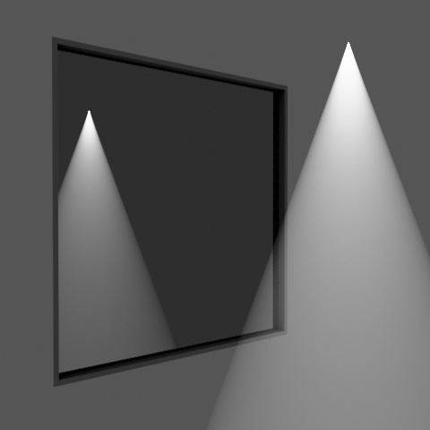

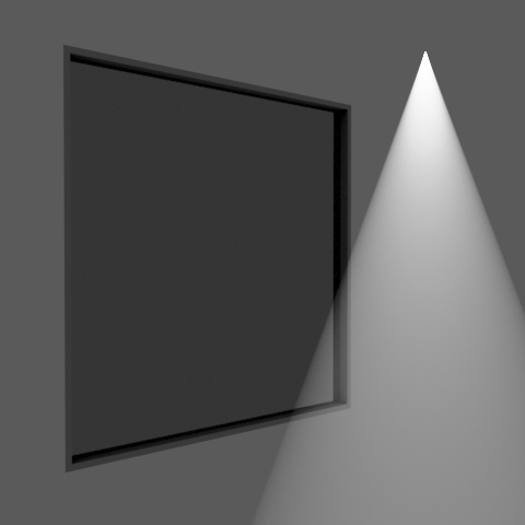

Thin volumetric spot light with a small cone angle
Specular
Controls the degree to which Atmosphere Volume affects specular rays.
| 0 | 1 (default) |
