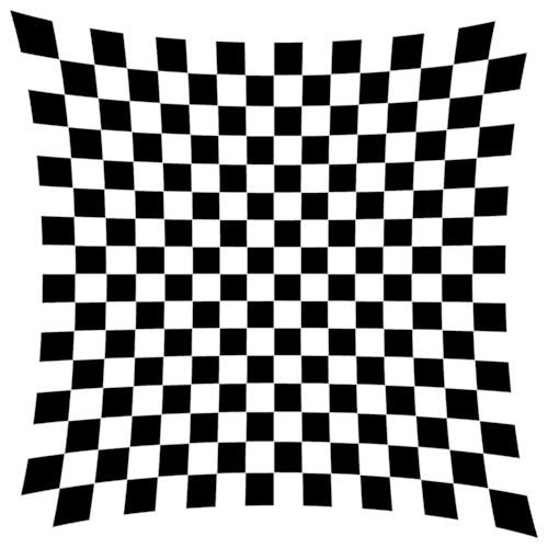

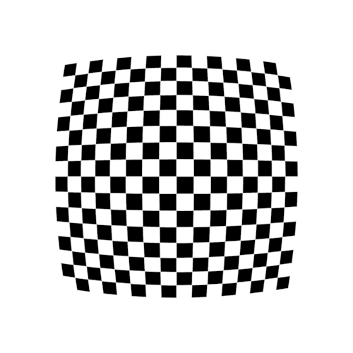

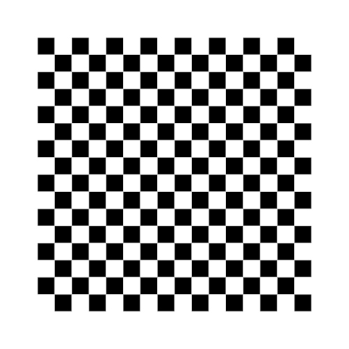

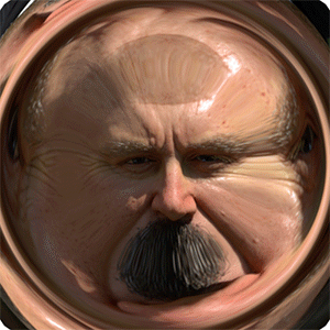

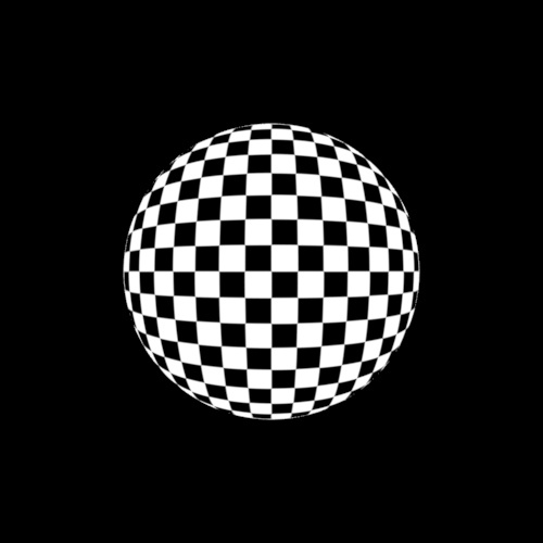

Radial Distortion
Radial distortion, with negative and positive values resulting in pincushion and barrel distortion, respectively. Real-world lenses can show such distortion when using, for example, a very short focal length or a high zoom.
| -0.1 (pillow distortion) | 0 (no distortion (default)) | 0.3 (barrel distortion) |
radial_distortion (-1.3 to 1)

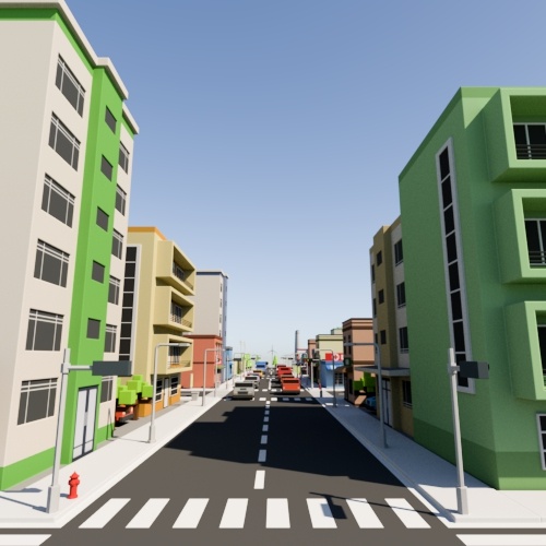

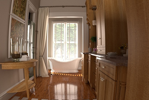

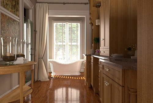

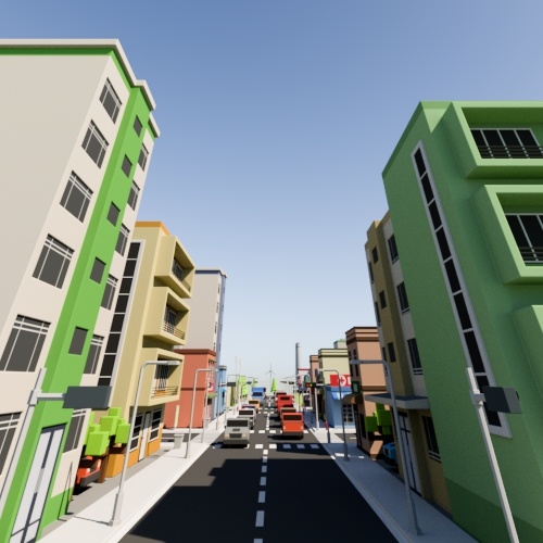

A 'barrel distortion' camera lens effect has been reproduced in the interior scene below, by simply increasing the radial_distortion to 0.2.
| 0 (default) | 0.2 |

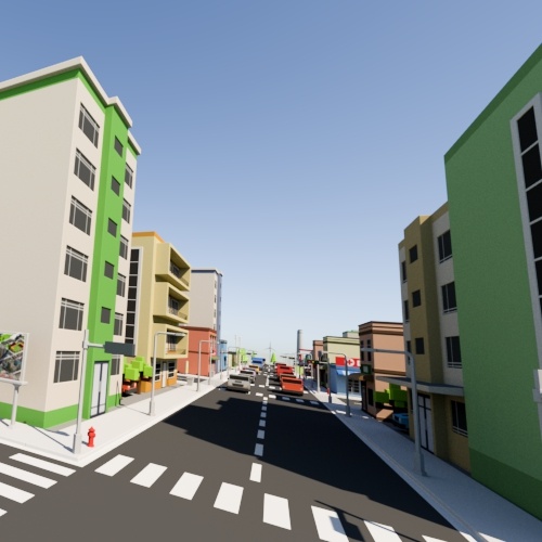

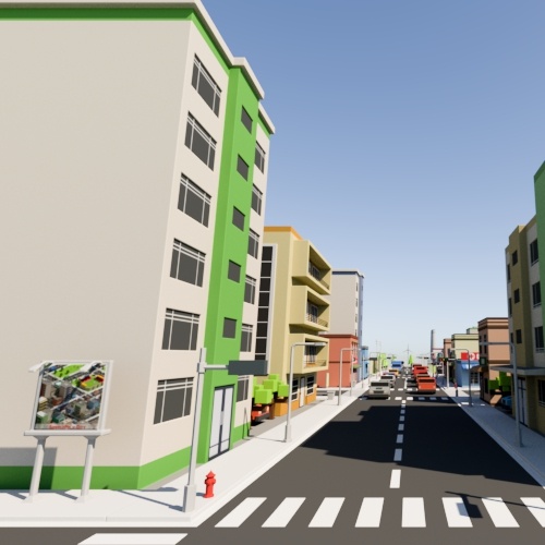

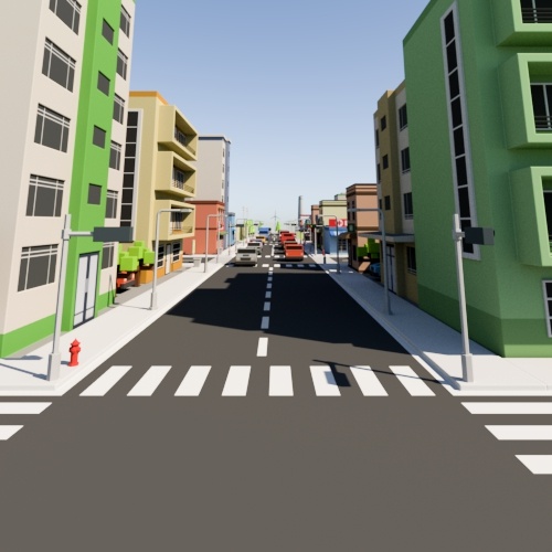

Lens Tilt Angle

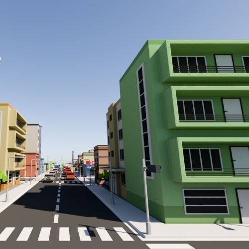

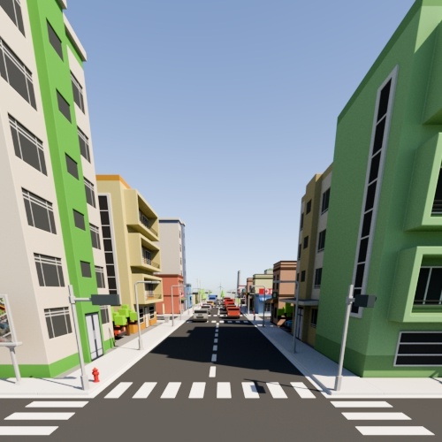

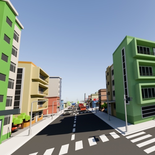

Controls lens tilt angles with respect to the projection plane. The horizontal and vertical angles are specified in degrees. This is useful in architectural renderings to compensate for perspective transformation for vertical lines.
| -30 | 0 (default) | 30 |
Horizontal
Vertical
vertical lens tilt angle: 0 to 15

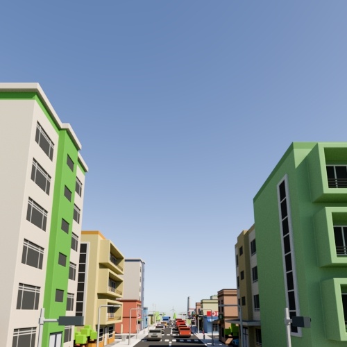

Lens Shift
Shifts the lens position. This is useful to recenter the subject after using tilt. The shift is given in normalized screen coordinates: +1 will move the frame center to the right or bottom edge. Note that lens shift will affect the render in a different way than screen_window, notably with distortions or vignetting since one is a lens effect and the other just selects the part of the rendered image that will be output.
| -0.5 | 0 (default) | 0.5 |
Horizontal
Vertical
