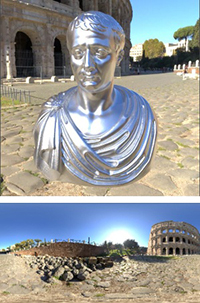

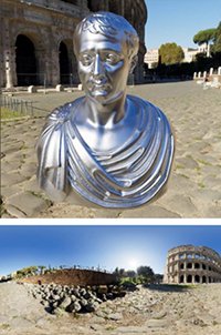

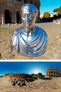

Linear HDR Map Linear HDR map opened as ACEScg (incorrect) Linear HDR map converted to ACEScg (Utility-Linear-Rec.709 or sRGB) (correct)
