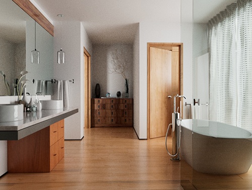

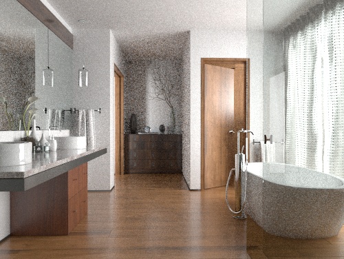

| without denoising | with Arnold denoiser |
The Arnold Denoiser (Noice) is a stand-alone program post-process denoiser executable. It works on EXR files with multiple layers and outputs an EXR file with the denoised layers. It takes into account multiple frames and multiple light AOVs. It requires variance information for all AOVs and optionally uses normal, depth, and albedo. Like most denoisers, it considers a neighborhood around the current pixel and looks for similar neighborhoods inside a given search area to blend together.
