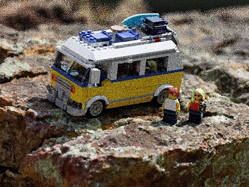

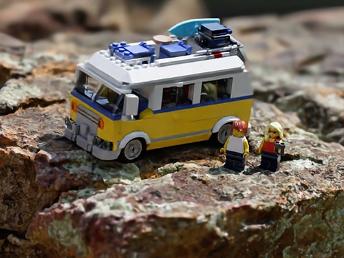

| without denoising | with Imager Denoiser OIDN |
The OIDN denoiser (based on Intel's Open Image Denoise technology) is available as a post-processing effect. It is integrated into Arnold for use with IPR as an imager (so that you get a very quickly denoised image as you're moving the camera and making other adjustments).
