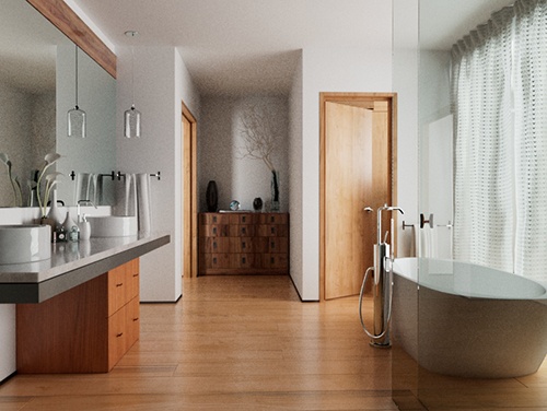

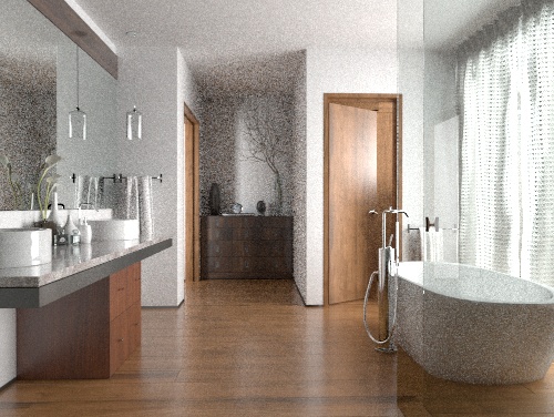

| without Arnold Denoiser | with Arnold Denoiser |
The Arnold Denoiser (Noice) is also available as a post-processing effect. You can automatically denoise images every time you render a scene, edit the denoising settings, and see the resulting image directly in the render view. Note that imager_denoiser_noice does not support temporal denoising ( required for denoising an animation).
