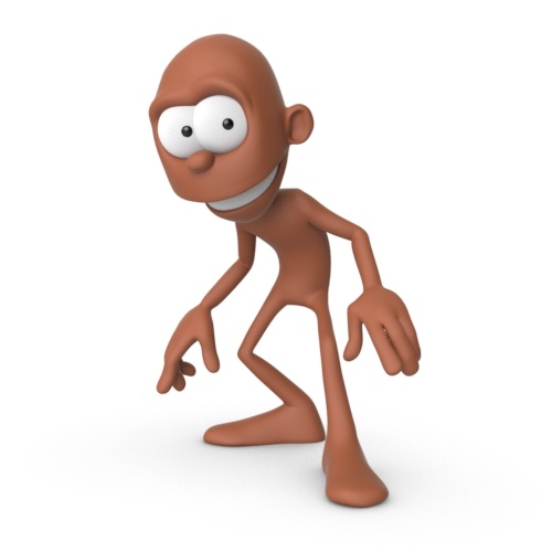

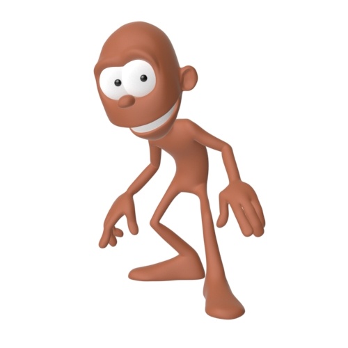

Ignore Textures
Ignore all textures when rendering.

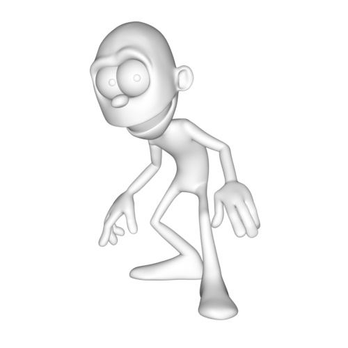

Ignore Shaders
Ignore all shaders when rendering; Arnold will render with a simple n_dot_eye shader instead.

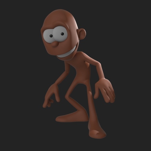

Ignore Lights
Ignore all light sources.

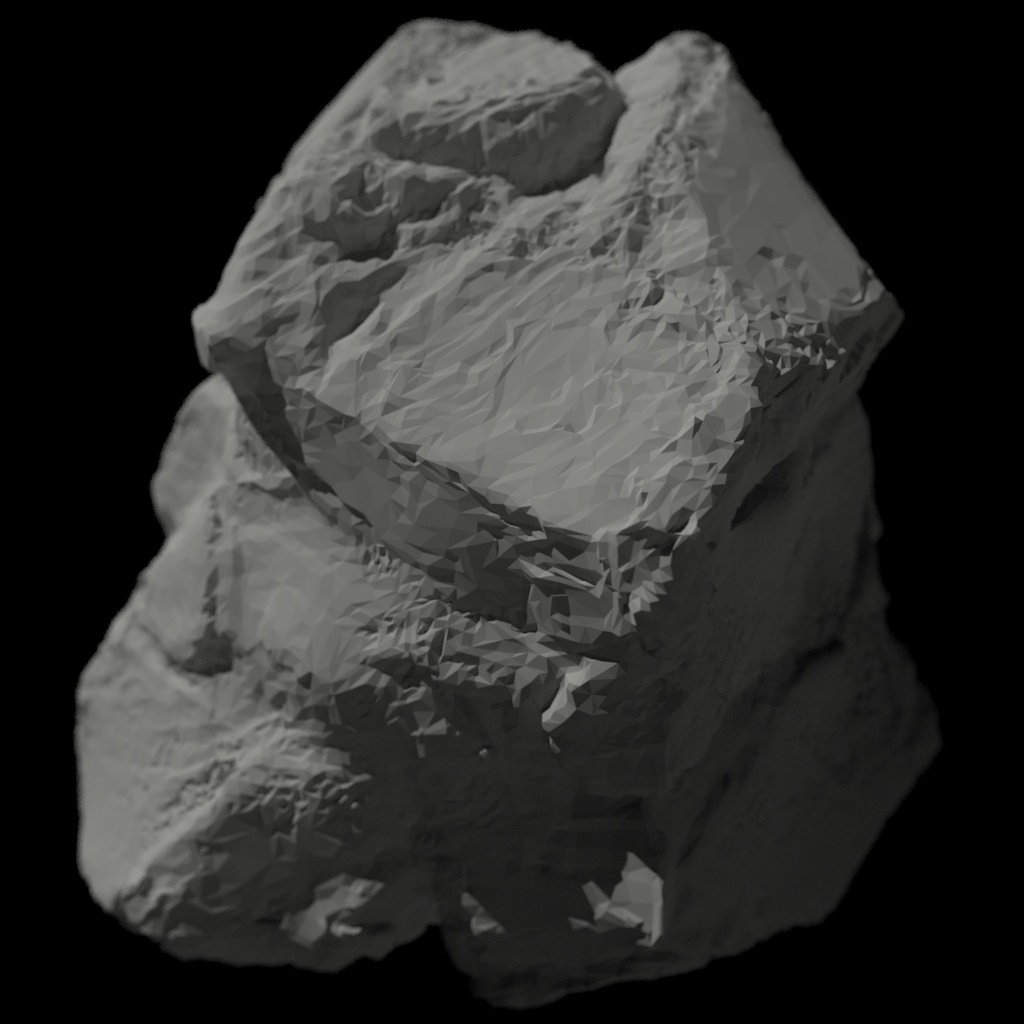

Ignore Subdivision
No objects will be subdivided. This parameter is not interactive.
Ignore Displacement
Displacements will be ignored. This parameter is not interactive.

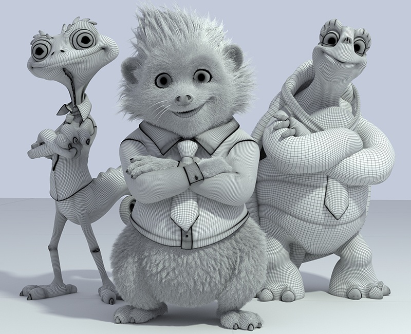

Ignore Normal Smoothing
Polygon normals will not be smoothed, resulting in a faceted appearance. This parameter is not interactive.
