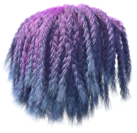

Root Color
Diffuse color at the root of the hair.
Tip Color
Diffuse color at the tip of the hair.
Root Color - purple. Tip Color - blue.

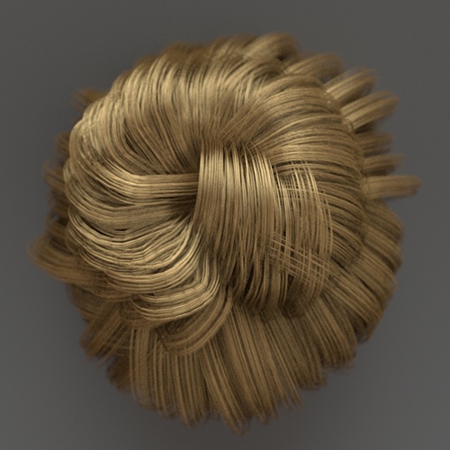

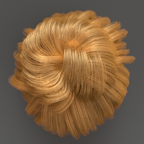

Indirect Diffuse
Indirect diffuse controls the amount of indirect diffuse light (GI light rays) reflected by the shader. Setting it to 0 disables indirect lighting and is the fastest to render. The higher the setting, the more that global illumination will affect the final color of the shader. It is strongly recommended to stay in the 0 to 1 range, as values higher than 1 will create energy out of nowhere and therefore break energy conservation and introduce excessive noise. The example below shows an exaggerated value of 5 merely for illustrative purposes.
0 5
