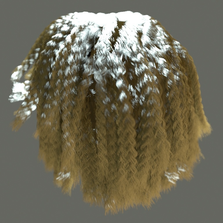

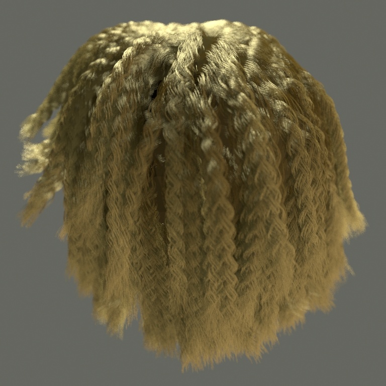

Color
The color of the primary specular component. For realistic and clean hair, the color should be set to white.
| Black | Brown | White |
It is also possible to assign texture maps to the specular color attribute. The image on the left is an example of some hair that has been rendered with a brown specular color. On the right is the same hair that has been rendered with a fractal texture connected to the specular color attribute.
| Brown | Fractal texture map assigned to specular color. |

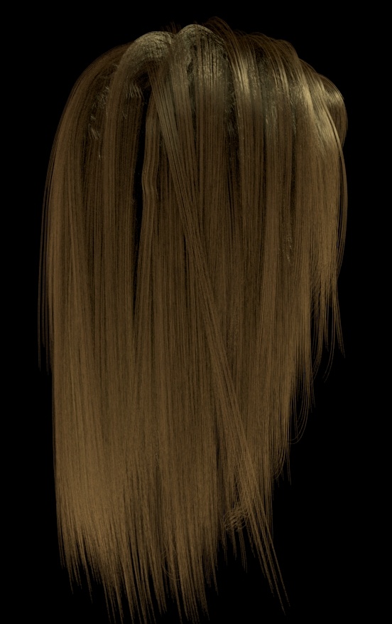

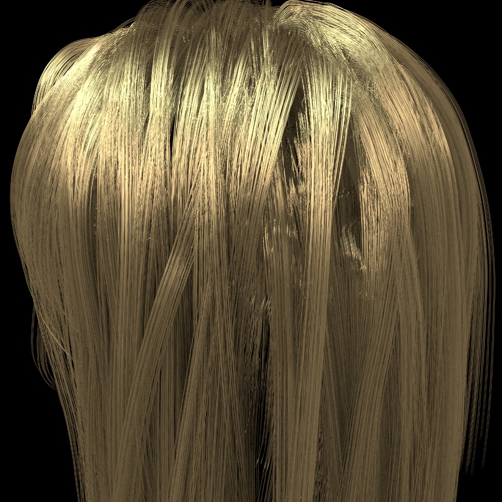

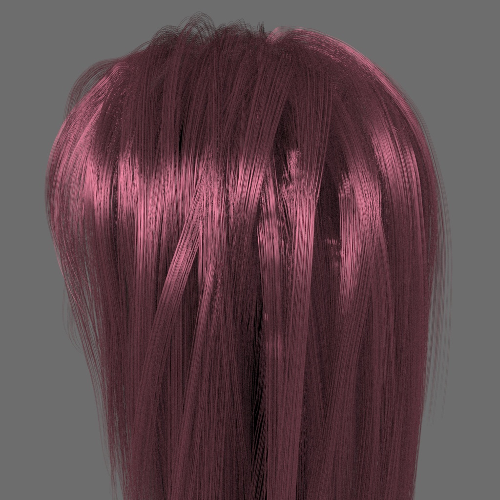

Angular Shift
Angular shift of the primary specular in degrees. It controls the shift of the specular lobes away from the perfect mirror direction and is used to control the offset of the specular highlight along the hair strand. For realistic results, it should take a negative value, typically in the -10 to -5 range.
| Specular Angular Shift -1. Secondary Specular Angular Shift 1.5 | Specular Angular Shift -10. Secondary Specular Angular Shift 7.5 |

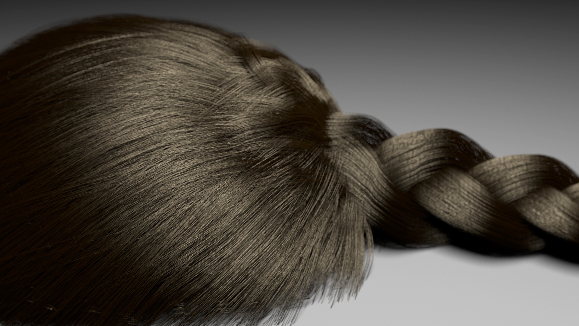

Secondary Specular
The Hair shader has a secondary glossy specular lobe with its own Scale, Color, Glossiness and Shift controls. The secondary specular tends to shift towards the root of the hair, which is achieved with a positive value in the Shift control. Even though in real hair the secondary shift is linked to the primary shift with the expression secondary shift = primary shift \ -1.5*, the specular shift controls are decoupled for greater artistic control.
The secondary specular usually shifts 1.5 times as much towards the root as the primary specular. It is also wider than the primary specular. The Scale of the secondary specular defaults to 0 to preserve behaviour when using materials from earlier versions.
| Primary Specular | Secondary Specular | Primary & Secondary Combined |
