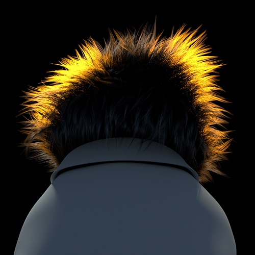

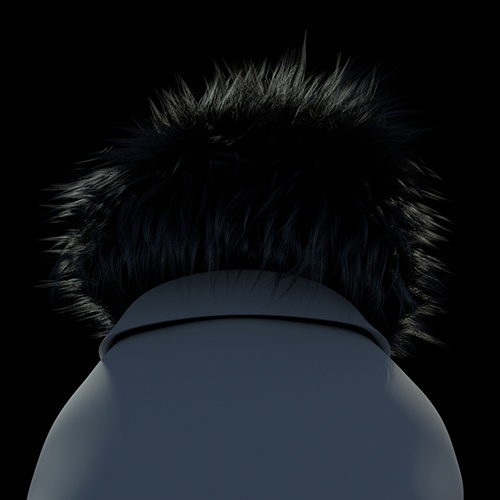

| No Transmission | Transmission |
Transmission Color
The color of the transmission component.
Transmission Spread

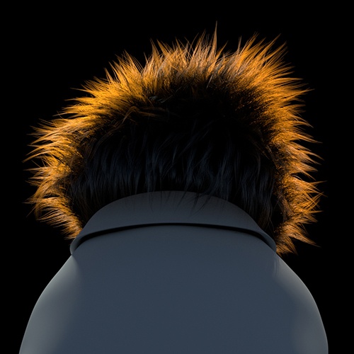

A multiplier on the transmission effect's spread: a smaller value produces a more focused, brighter effect. The default spread is 1.0, which corresponds to a realistic look for blonde hair . Reasonable values should be within the 0.5 to 5.0 range.
| 1 | 3 |
